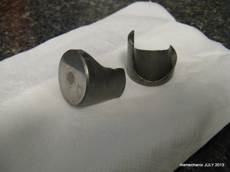

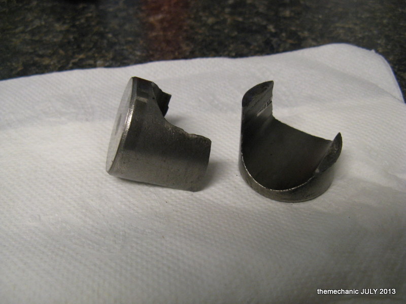

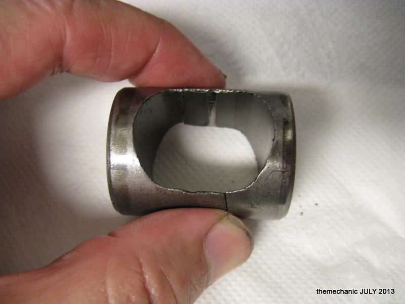

Look what I found in my rear diff housing today.
themechanic
Oklahoma is OK
3:34 PM
Nov 11, 2012
21,954
28,296
Moore, Oklahoma
I found a broken thrust block in my housing when I pulled the 741 case today. It has 2.76 open gears. I am swapping it for a 489 sure 3.55 grip. Anyone know what could cause the thrust block to snap in two?
Thanks FBBO
Trash in the rear diff housing.JPGTrash in the rear diff housing-001.JPGTrash in the rear diff housing-002.JPG
....or a very heavy right foot :glasses10:
Improper end play adjustment.
You may be right. The end play adjuster is frozen due to the flange being bent and rust. Looks like new parts are needed.
:beavisnbutthead: Shredin it! :3gears:
I wish. The car has spent more time on jack stands than on pavement. Maybe this fall????
