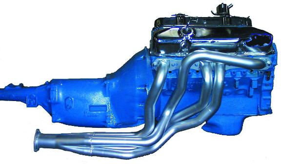

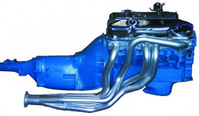

Looking at brands and reading reviews it boils down to two manufactures, TTI and Headman. The Headman Elites and the TTI's have the same spec's on paper, 3/8" Flanges and 14 gauge pipe. Same coating and the Headman Elites are literally 1/2 the price. So it's hard not to choose those pipes. The one difference that I did find was the Headman's use the "Ball and Socket" collector and the TTI's use the old school flange that I'm very used to. But Headman has been around for eternity and this change must have been for a good reason and I would like to think improvement. So any comments there would be good too.

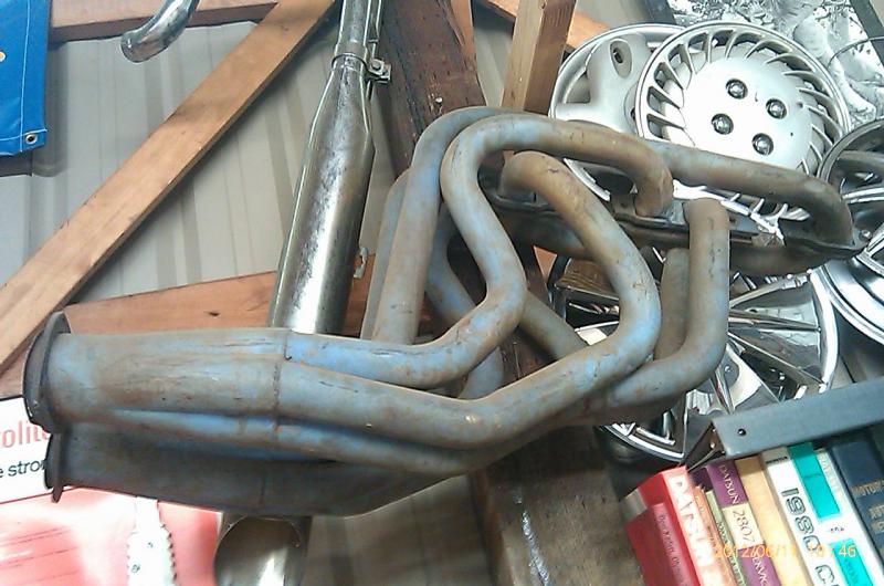

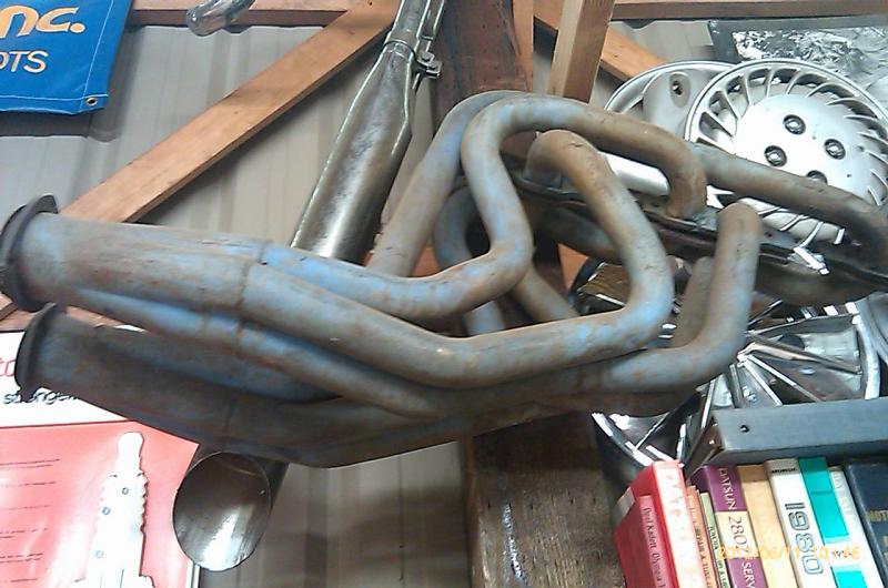

For you gentlemen that have '65's can you identify this set of headers. This is an old set that I took off my Satellite. They also are the same as the ones that are on the car now. Looking at TTI's and Headman's pictures the pipe for the first cylinder goes down before the fourth one. These headers here in the picture has the first cylinder going all the way over the top and down the rear of the 4th cylinder. As I mentioned in this thread I am looking to buy a new set of headers to just have so I won't be attempting to install them for awhile so I really want to cover all my bases and make sure I get something that will fit.
Thanks for your opinion on what I have here on the old pipes. I so appreciate all your help and experience.
Lisa

Lisa;65's are the same as 62-4's in the engine compartment. Those headers look more like a 66-up/E-body application,and I can't identify the brand. Any idea of the age? I don't recall Cyclone doing that app,Doug's look different;maybe old CPPA pieces? What size are the pipes? That might help. I lost all my old catalogs in a basement flood years ago,or I could check them for you. Good luck with the car,and welcome to the best funhouse on the 'Net!
I thank you for your response Al K. I hate to admit this but those headers are 40 years old. On the tube size I may guess at a "standard" size of 1 5/8 inch. There not a max performance header. I certainly appreciate the additional information on the pipes and the engine compartment. As I mentioned I want to get a new set just to keep with the car so I want make real sure that if the headers that I will buy today, even though they look different they will fit. Also for all these years I have been curious as to who made these pipes I have.

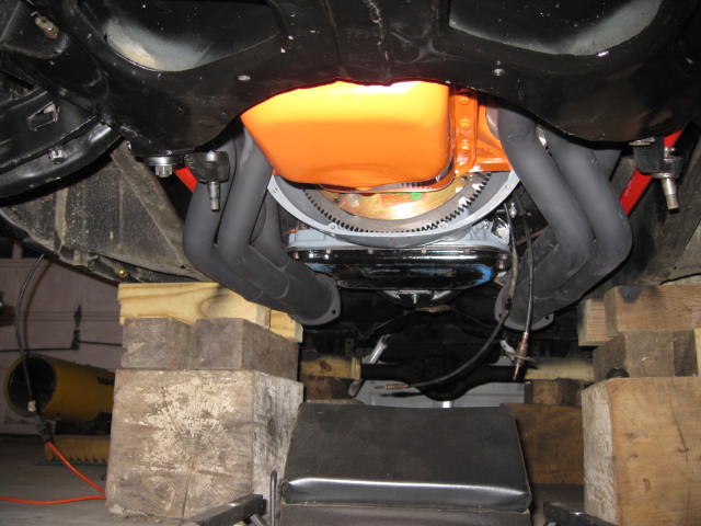

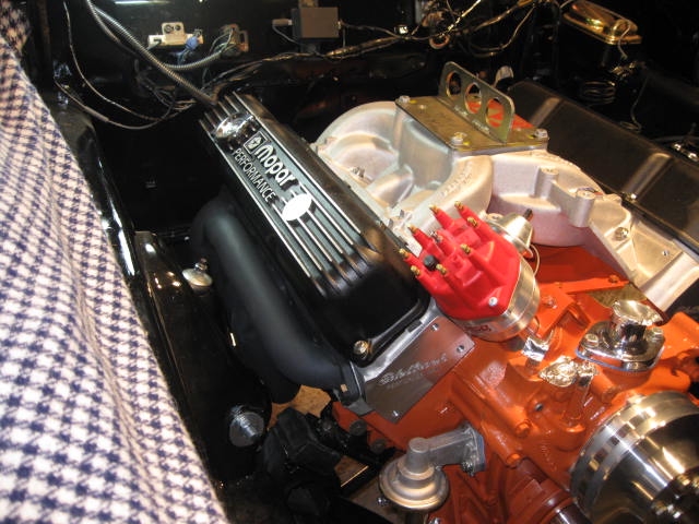

satillite new motor 047.JPGI have 2" TTI headers in my 65 satillite satillite new motor 036.JPGwent right in no time at all fits great and they look real nice.
Exceptionally beautiful!!
Nice job and they had to fit easily as you couldn't have put a scratch on anything there.
Lisa:icon_thumright:
