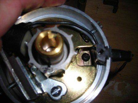

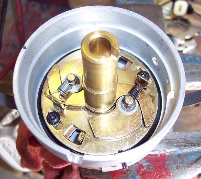

The MP that are the mallory guts fits your bill unless your looking for every .010 you can gain in time. Electronic right? Bottom line alot will work AS LONG AS THE CURVE IS RIGHT. Vacuum advances can only be adjusted for the rate of advance not the amount. FYI

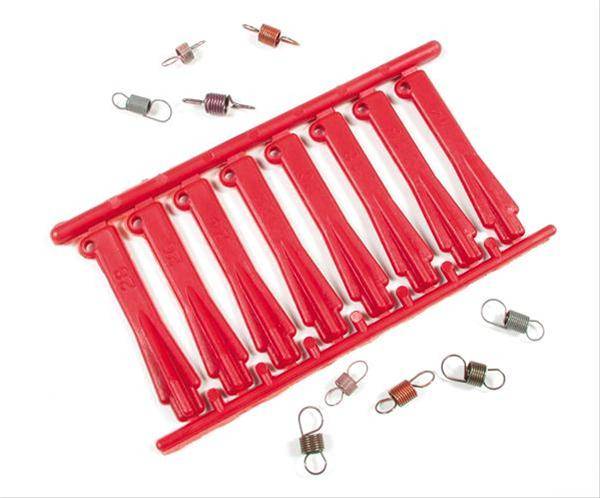

Mechanical advance is adjustable, you can still get the springs for the rate of advance and the setting keys also.
