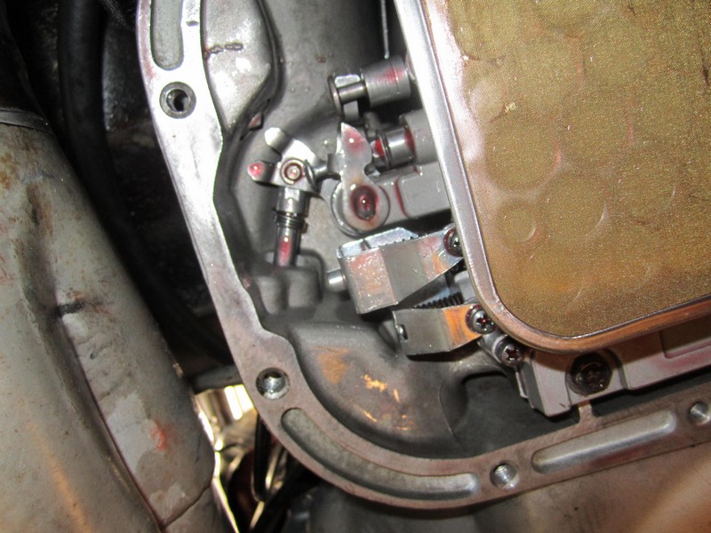

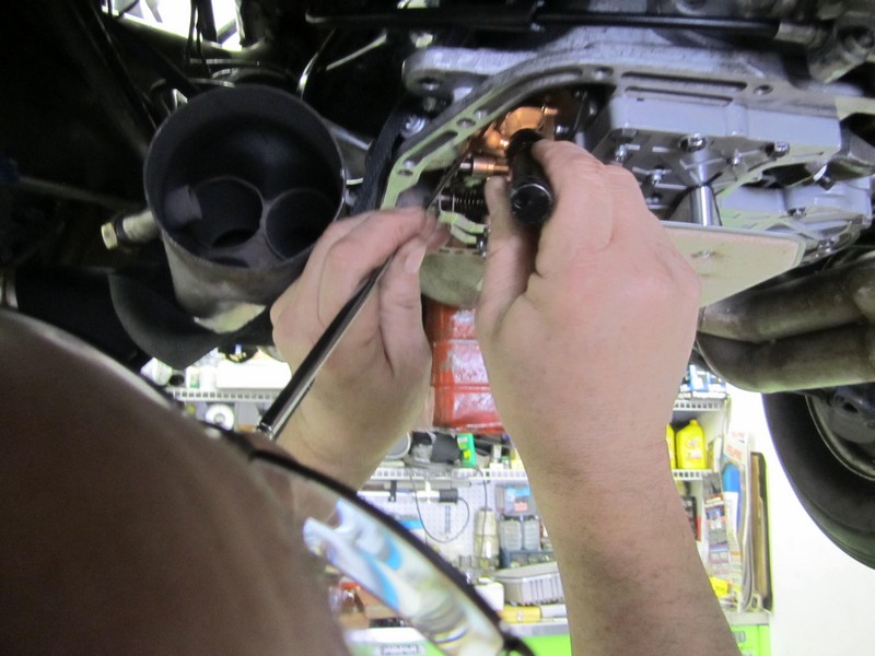

Kill 2 birds with one stone. Drop the pan to adjust cable and verify the rooster comb pushes in the neutral safety switch.:blob1:
