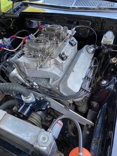

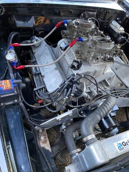

The Motor I believe is stock stroke 440 with a big dome piston, Indy SR Heads must have been ported to max wedge since its running 440-25 intake, Edelbrock 750 carbs, Big Flat Tappet Solid lifter cam. North of 600" lift. Ignition is MSD Digital 6.
Notice that the intake has nitrous burst plates, I did find evidence of a minor fire at one point. I'm guessing these intakes have been known to backfire due pooling fuel.
I did a compression test and all the cylinders are between 98-105psi, Seems low to me. guess the cam has a big overlap! Rockers lash is at .022" intake and exhaust. I did the once over on the whole car, Fresh 112 Gas, went through the carbs, replaced some fuel line. new plugs, wires and penn grade 20/50 oil. 70-80 oil PSI.

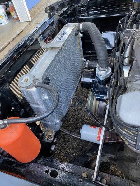

Car will not idle under 1500 RPM... Seems to get hot really fast 10min with the pump and fans running and we're over 220 degrees. I can't put a timing light on it since the ATI balancer had some corrosion and destroyed the numbers and marks also the passenger side lower radiator hose is in the way of the timing pointer.
Tomorrow I'm planning to pull the intake and reseal just to make sure there's no hidden vacuum leaks, tried spraying carb cleaner around potential vacuum leaks but didn't fine anything obvious. I'm also going swap the radiator to stock copper 4 core and change out the balancer to another ATI I have.

Aluminum crossflow is way better than a factory copper radiator unless
the Aluminum is partially plugged.
You could put timing tape on the dampener and save changing it.

I would do a cylinder leak down test, that will tell you if the compression is low due to wear, or cam timing issues. With dome pistons and a big camshaft, I would expect to see 150 to 175 cranking compression. To kind of verify the cam timing set engine to TDC on the overlap of the cam, if the intake rocker is lower it is advanced, if the exhaust is then it is retarded, same height both rockers cam installed straight up.
36 to 38 degrees total timing works on any big block I have messed with.
I've run this intake for 10 years. It should idle with no issue. My cam is [email protected]" and will idle at 1000rpm. Seal up the intake. Make sure the adapter plates that mount the carbs are tight. Use blue loctite in the bolts. These plates will loosen up. I made gaskets for them. For the lid file a 1/16"x 3/8" notch on the forward sealing edge. That way you can get a screw driver in between to pop it apart. If not they are tough to seperate. I use Ultra Grey to seal the lid. Jet 113 primary/110 secondary 68/47 rod. It will be very close.use the mid to lighter tension metering springs. 34 degrees total timing. To start the the engine. Pump on to fill the bowls. Then pump off in case of backfire. Hit the throttle to th efloor twice. Now wait 30 seconds. Ht the the throtle again holding it half open. It'll start like fuel injection. Always start with the throttle open. If it coughs it gives the prssure a place to go. If it's below 50 degrees; though a cloth fender cover over the carbs to act as a choke. Once it starts pull it off.

im thinking thats way to much intake manifold for that cid engine. they work well on large cid engines and it sounds like it has a air leak to. you are correct about the blowing up and fire thing. i was a victim of that myself. i put a modman with two 750 afb's on mine and it loved it. i had to do a little tweaking on the pump shot to take a small stumble at the hit out. i have a 451 cid engine, 13.5 to 1 compression, 440-1 heads hand ported ,705-710 soilid roller cam and have been low nine eighty at 136mph. nice looking car i hope you get her figured out.

before wasting ur $ on a diff. radiator , move the existing one up to the cradle and seal it , being that far back is stupid , "air going around it instead of thru it !!

After using a piston stop and finding true top dead center, I marked the ATI balancer and installed some MSD timing tape. As I rotated the motor to TDC I noticed the Rotor pointing to the #1 Terminal on the cap while the Balancer was showing 50 degrees advanced... Really... WTF. I double checked, ya its for real!! Wow 50 degrees initial advance. then looked into the mechanical advance and they had the blue bushing in it adding another 25 degrees by 2800 rpm... No wonder it wouldn't idle..
So I adjusted the mechanical advance to 18 degrees and set the initial at 18 degrees, for a total of 36 degrees all in by 3000 RPM. WOW!! What a difference! NOW It Idles between 900-1100RPM! I also swapped out the Aluminum radiator I think it was clogged, for a good 3 core original water temp never got over 180 degrees after running for 20 minutes..

The manifold in question Indy 440-25 is a very good manifold. I dynoed one back in the day on my old 498" motor. Indy -1's out of the box, 13-1, .680 roller, 2 Eddy 750's. It made 658@5750 with a factory crossram. With the Indy it made 720@6750. We started the pull at 4000rpm. It was better at every rpm level. My 580" motor currently runs one as well. No one in NMCA with -1 heads has gone faster even using a tunnel ram. Not to mention I'm close to 200lbs heavier. Been 8.96@150

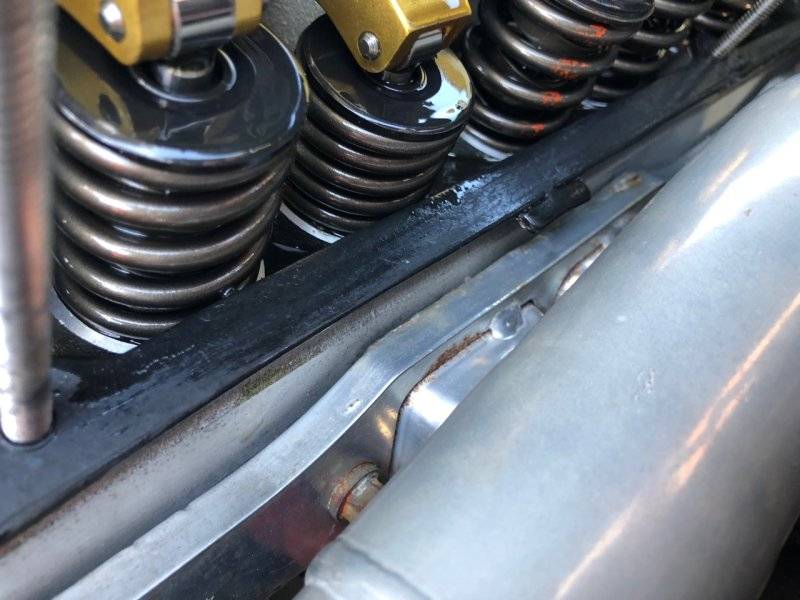

Ok here's an update, a few weeks go I took the car to the track. After some shake down passes, the car ran consistent 11.70s @ 114 - 1.62 ' , My erratic idle issues showed up again. Temp was in the mid 80's and coming back the return road water temp was 210-220f.
Since then I have swapped the cooling fan to a puller, locked the timing down to 34 degree's total, Pulled the intake and carbs resealed every possible leak, and seen evidence that is was leaking at the #6&8 ports. I checked all surfaces for flatness, and resealed and reinstalled, found some clearance issue with carb linkage, which was fixed.
