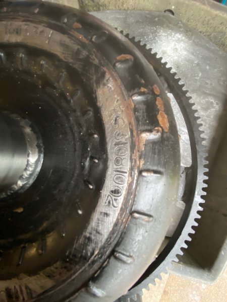

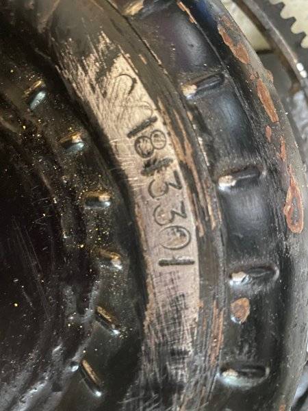

Ok the next issue... I pulled the trans to fix a minor leak at the convertor. Looks to have a Frank Lupo convertor, Anyone know how to ID them?
9" convertor
The numbers are :
1813301
RS31081002
1708PST083S

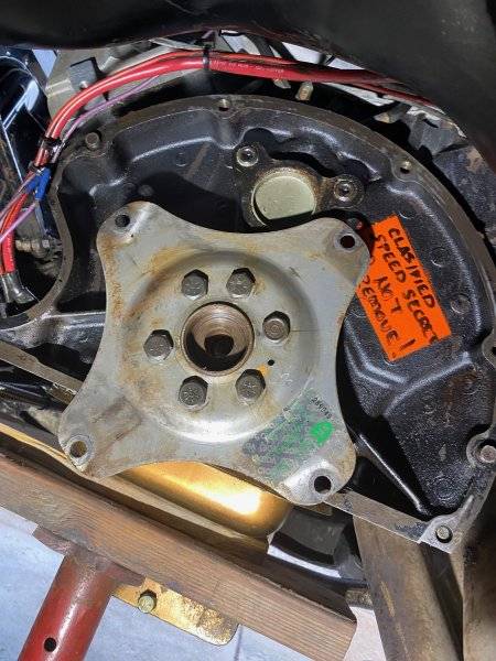

The previous owner also left a message on the back of the engine that spiked my curiosity! See Photo
