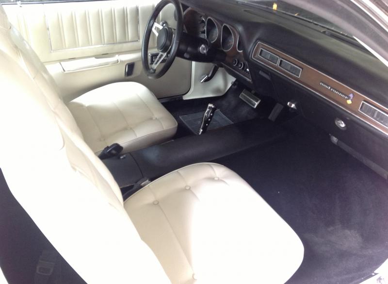

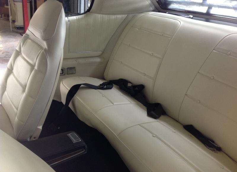

I purchased my seat covers and other misc. interior items directly from Legendary during one of their sales. I think it was a 20% off sale. Before I purchased from Legendary I checked around with other suppliers. I asked each of them to send me a swatch of their material. Legendary was the only supplier that I could find that had the exact match for color and grain of the vinyl. I used a swatch from the bottom of my old seat covers to compare the new swatch samples.
I did all the work on my interior myself. My first time. It is not easy work but satisfying when finished. I still need to have an interior shop steam the seats to remove the small wrinkles.

I had some wrinkling/crease issues in the center of the rear seat, but they have 95% come out on their own after a few months.
Great service.

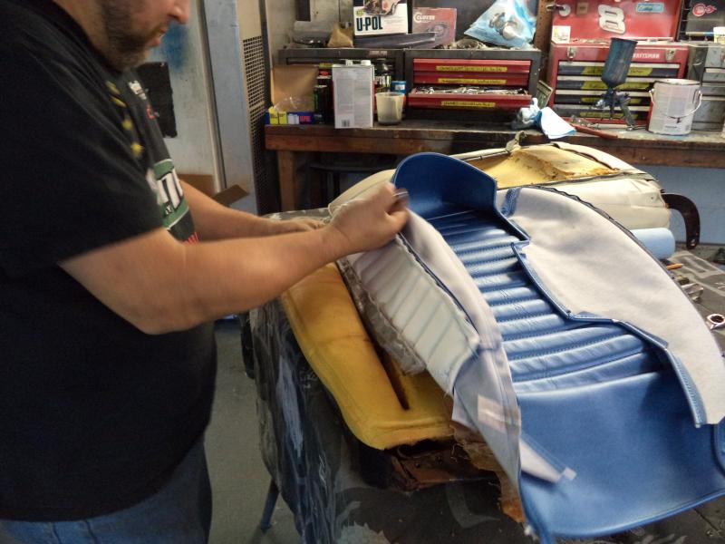

Legendary, Dantes,Moparts member group buy in the spring. Great stuff. Only thing that would beat it is to buy NOS material from SMS Fabrics and have Legendary sew it up. Which by the way did everybody know that Legendary will make you a set of seat covers out of material you supply? They used to do it for about a $100 less that full price but now I think in their busy seasons they charge the full price. But it is a cool option. You can also order any seat cover in any material they have, not just the stock colors. Couple of tips for the OP. Do one seat at a time, there are some things that are tricky to put back together. The side adjuster knobs can be a bear to get off, so use some heat. And if you rebuild your seat tracks, be careful taking them apart, there are little plastic holders with ball bearings in there that could be destroyed and are hard to find. But taking them apart and cleaning will make them super nice. Totally agree with idea to get new seat backs and there is a new supplier on Ebay that has some that look promising.

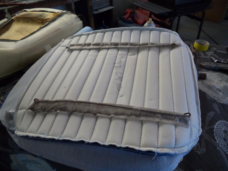

Another difficult area is the listing wires that run vertical in the seat backs.
I'm stuck on those and still using my aged seat backs with the new bottoms and back seat.
I'd love to see how to tackle those.
I haven't yet taken my seats apart yet. What are the listing wires?
The listing wires are what gives the seat it's "bolster" and shape around the insert. They are attatched by hog rings and run through pockets in the seat cover. Here are some pics:
