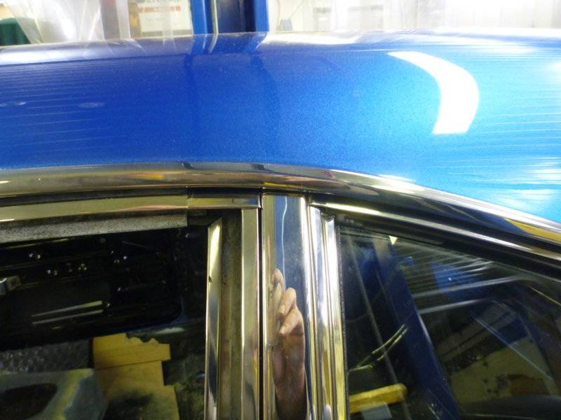

Buy a few buffing wheels and do it yourself.. would have saved me 5 grand CDN and then realized I could do it myself just as well or better !

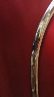

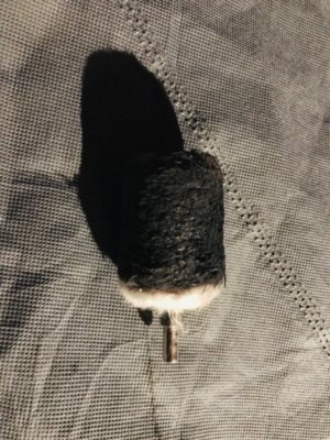

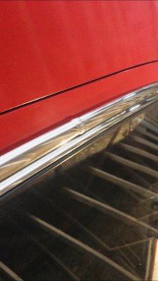

Agree with dadsbee. Polishing stainless steel is no different than polishing aluminum or paint. It’s actually a lot easier because it’s already at a very smooth stand point. Anyone would be insane to pay someone else to do it for them. It’s easy as it gets. Wet very fine sand paper, a drill with a buffing fob and a proper compound. A green polishing compound is the softest and designed for stainless steel. However, if yours is very bad you may want to start with a black compound also designed for steel. Because it’s harder in density. Which I highly doubt yours is at the point needing anything but green. I just sold a 70 year old car that I polished the original stainless trim. Only involved an hour of time and it probably looked better than it did when it rolled out of the factory in 1950. Green is best for a final compound. The more time and effort you put into polishing the better it looks. Stainless steel is easy as it gets. Referring to effort, time and result. If yours is heavily scratched in places you will need to involve more time into wet sanding. If scratches are minimal. You will need to involve more time using a compound vs wet sanding. The wet sanding will remove heavier scratches. The polishing compound will bring out the shine. Both will be needed. Depending on how abundant or heavy scratches are.

You don’t need a bunch of elaborate tools. Besides a high speed adjustable drill, some wet sanding paper between 1800 - 2500 grit and green polishing compound. This is all you need. $3.99 at Harbor Freight. It’s not rocket science. It’s the easiest thing to do imaginable.

The parts don’t have to be removed. 70 year old stainless trim. Had paint overspray on many pieces to boot. 1-2 hours invested at the most. Minimal effort.
