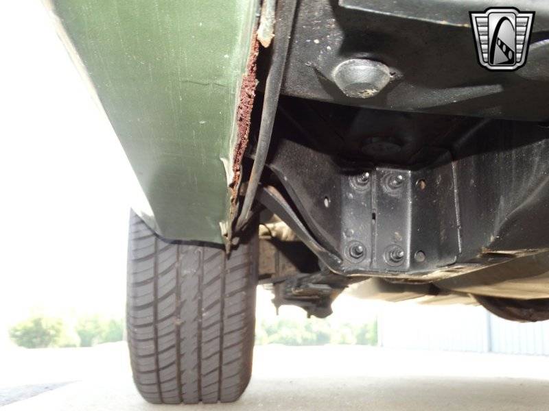

Greetings from NorCal again. First off, a big thank you to all of you who have guided me and provided input this far in my search for a Super Bee. So after reading a bunch here and looking at 3 Bees and coming down to really 2, this is the one that is in the lead at the moment. I was hoping you who know far more than I could give it a look and see if it's a fair deal. I would ask a few k less but I think the body looks killer. Under the hood needs a few things like a fan shroud, maybe some mild clean up. The undercarriage looks like it's been well cared for, maybe some spray paint but no major rust or issues I can see but not sure what's up with the weird anomaly on the pinch seams. I've spoken and emailed with homie at the dealer and the story is it was a frame off resto about 10 years back. Since then it's been sold to the present owner. Reportedly has about 4-5k on it since the resto and engine, trans, diffy, and suspension have been gone through. I don't need a perfect car and for the price, this seems to me to be a fair deal. And I figure I would likely need about 5-8k to make it how I'd like it and fix any of the "little" things that need attention. Thoughts, input, opinions appreciated.

Buyer beware. The painted door latches and strikers tell me this was not a quality restoration. More like a quickie paint and flip. The rust flakes in the pinch weld might be a tell tale sign of some body repairs.

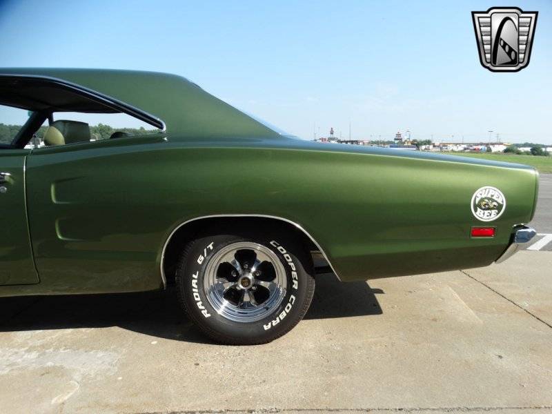

I agree with the others that you need to pass on that one. That rust on the rocker pinch welds is a huge red flag which will cost a pile of cash to repair. But hey, when you repaint the car, that would be the time to remedy the backwards Bee stickers on the rear quarters, lol. It took me 6-7 years of searching to find a decent Super Bee. There were far fewer of them made compared to RR's and Chargers, and why there are fewer to choose from now.

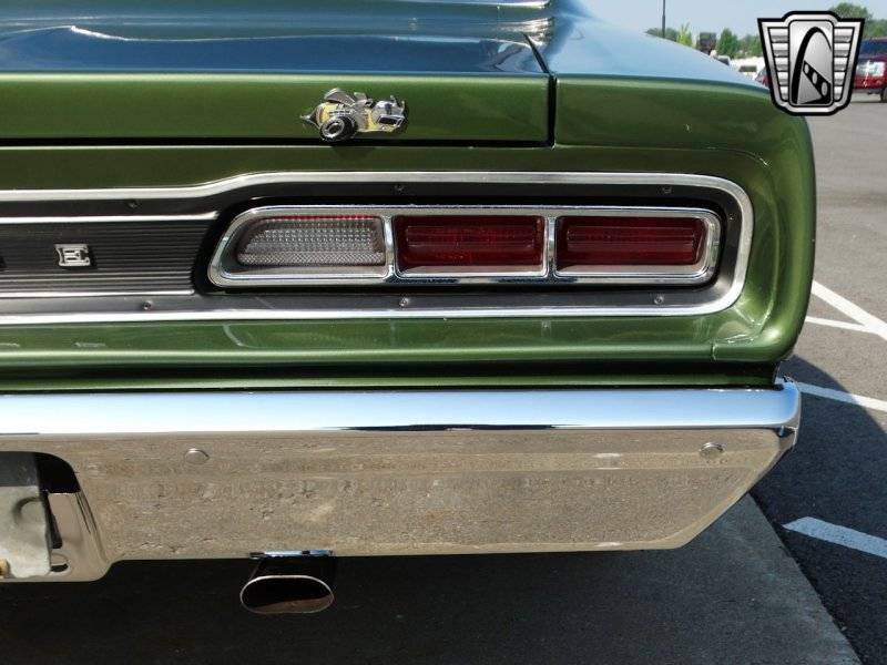

I didn’t notice that the emblems were backwards when I first looked at it. That right there is a huge red flag. I the Bee emblem on the truck lid caught my eye too. Something seems off wit it, but I can’t put my finger on it. Isn’t that emblem supposed to be on the center panel between the tail lights?
The Chevy guy that restored this car put the Bee on the 1/4s backwards.

If you had bought this Bee, I guarantee you would have had buyers remorse in a few months. Probably sooner if you took it to a car show, and everyone kept asking you why the emblems were on backwards.
No, not in 69, in 70 yes. I could be wrong but I did a couple bees back in my day.

They don't mention if the engine and trans are numbers matching ir if they are even year correct. For that miney I would expect numbers matching engine and trans. The rockers do give me pause.
