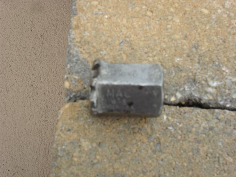

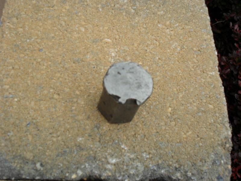

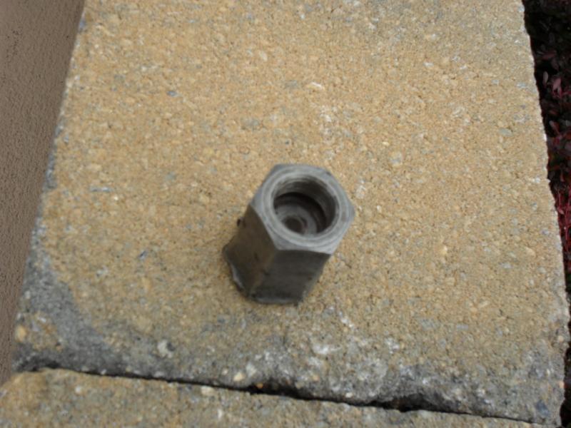

Just a thought-Been pulling tapered rear hubs since 1966 when I started at a Chrysler Plymouth dealer and have never used a puller because that's what messes up the threads even when you put the axle nut flush with the end of the axle,but if you use one of these axle knockers it works very well.Leave wheel on hub,remove axle nut and washer,screw knocker on and bottom it out,turn wheel so that keyway is at 9 oclock pull on the tire and wheel with your left hand and hit knocker with the largest hammer you can swing it should pop loose always has for me.My axle knocker was made by Mac and # is W-2,3/4x16 thread. SAM_2458.jpgSAM_2457.jpgSAM_2459.jpgas you can see it is well used.
