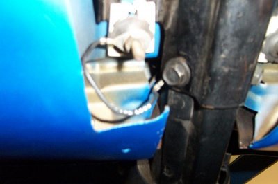

Here is the column ground wire.

I have installed the ground strap and it only grounds the steering column case not the steering shaft. What grounds the inner steering shaft? I loose the ground to the shaft that the steering wheel attaches to when I unlock the column with the key to start the car. The locking mechanism when locked is what is grounding the shaft to the outer case and with that ground, my horn beeps.

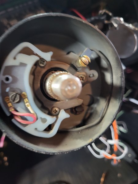

Columns with this type of column housing to dash frame jumper also depended on a staple in the rubber upper shaft bearing insulator for completing the horn relay circuit from the column housing to the shaft/steering wheel.
