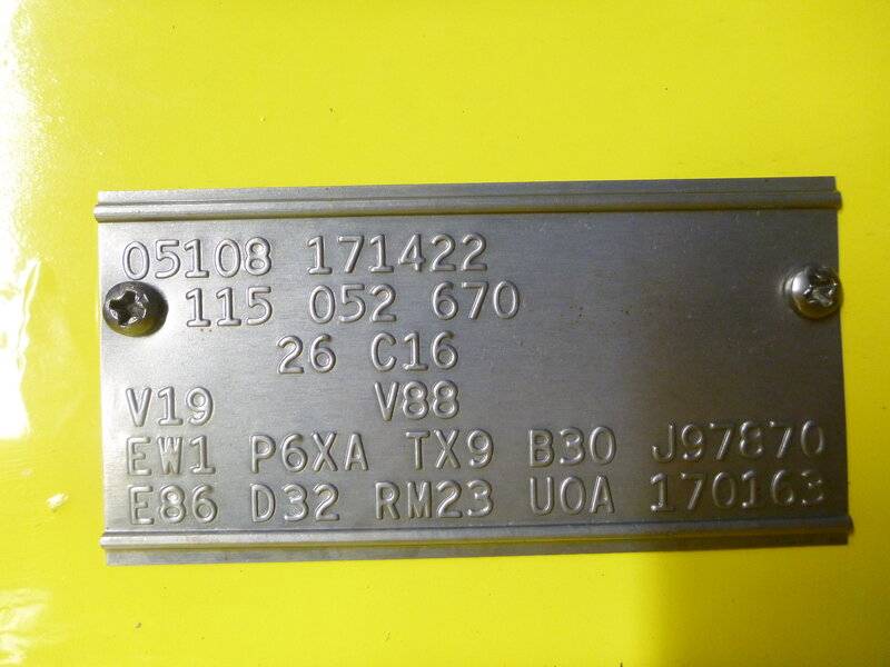

Pretty sure he did my Bird's correctly, from my 1.5 broadcast sheets. If there's any font issues, I can't see it (other than the tops of the 6's may be a touch short) but don't care as I've publicly told everyone here and elsewhere is a repro to replace one that grew legs in the 80's. No attempt to ding it, bend it, put inspection stamps on it, etc. It is what it is a reproduction, clear coated and screwed in place to fill that blank space on the inner fender. Of course the sequencing number on Lynch is an educated guess, as without the original fender tag there's no way to prove for sure it's correct or wrong.

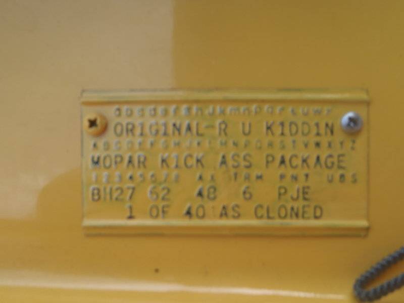

And OE for comparison..
