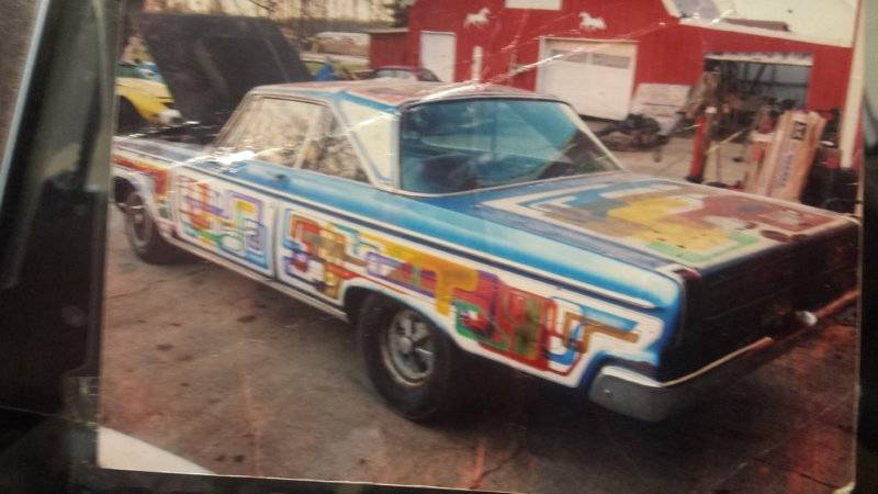

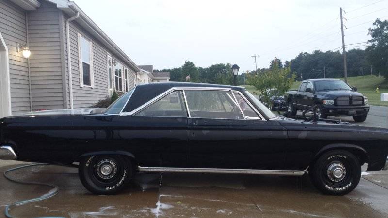

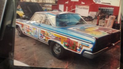

Im going to try the 68 b body exhaust. It's about $500 less than the 65. I have a welder and torches. Here are pictures of before and after.
View attachment 637419 View attachment 637422
