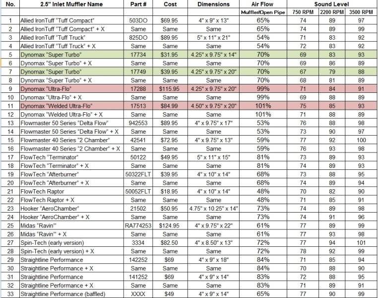

Here is the flow chart...
Another thing to think about would be sound insulation. I pulled my interior and installed Killmat on the floors and in the doors and rear panels. Added a thicker package-panel. Most importantly, I installed rolled duct insulation behind the rear seat. It has made an amazing difference.
Sam, I think the chart was done by Wayne state university quite a while ago to show the flow differences between the then popular turbo mufflers vs open pipe.
Correct, No OEM mufflers were tested - I guess they weren't considered a performance muffler.
Otherwise, the chart is comprehensive. I avoided jail with the purchase of OEM Hemi mufflers, so I have a fondness for them.

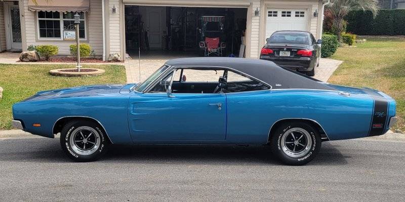

I just purchased the car pictured. It has a 440 with headers, 2 1/2" exhaust with 20" long dynomax ultraflo mufflers.
Problem is, it is LOUD inside! Between 45 and 55mph you can't even have a conversation. After 15 minutes of driving, you have a headache!
I don't mind a nice rumble, but I need to at least hear myself think!
So what do you recommend, different mufflers or resonators?
And with mufflers or resonators, can you recommend specific ones that will quite it down a lot. ( I dont mind losing a few horsepower)
Also I've read of people recommending glasspacks (Like cherry bombs) as resonators. Would those be better or units designed as resonators?
Thanks to all!
