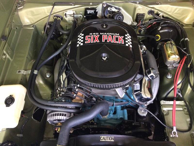

I am looking to add a/c to my 69 Super Bee 440 6 pack. looks pretty tight with the big air cleaner and the compressor. I like the compressor on the passenger side and alternator on the driver's, but, looks like that can only be done with a serpentine set up, and I don't have enough room for that and keeping the clutch fan. So, then electric fan, that I really don't want to do either.
I know Bouchillon makes a low mount, but other that being expensive, it looks like it is difficult to install, and no mechanical fuel pump. Again adding more items to the mix.
Any ideas on brackets that could switch the alternator and compressor, or low mount brackets that work? Thought I'd see what others have done.
I modified a six pack air cleaner so that in the future the compressor will fit on drivers side. The base was damaged so I didnt mind trimming it.
