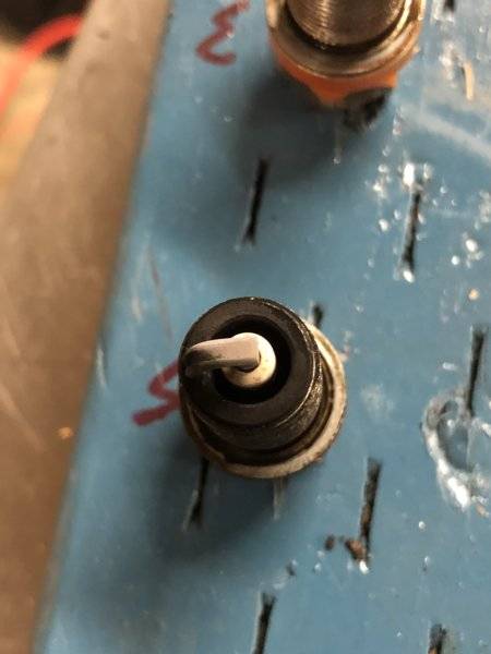

Now I am down to either the MSD 6AL Digital box as the culprit or the plug wires or plugs. That is if the ignition system is the issue. Plugs and wires are new.
Here is another symptom, I was idling down a hill in 3rd gear, about 1200 rpm, slow and the car just starts bucking rather violently. Same pattern as what I feel under low power low RPM.
I'm not convinced at this point that its ignition system. This MSD box was on the car prior to swapping in the 440. I never moved from its location so the chances of something happening to it are slim.
