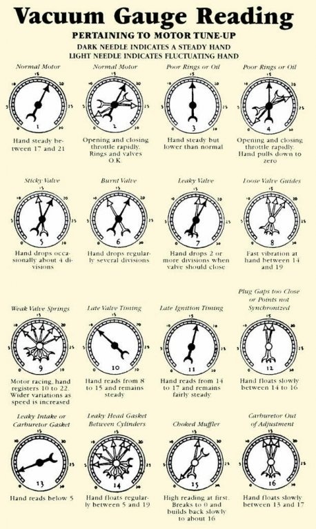

I'm experiencing the same problem with my 383 with an Edelbrock1405. I'm pulling about 10"Hg at idle at 900rpm. and my vacuum gauge will fluctuate around 1 or 2" intermittently. I'm thinking either I'm still a bit rich or I've got a bad plug gap with one cylinder. Hopefully not a sticking valve.
This chart has helped me out in the past. It might be some assistance to you as well.
