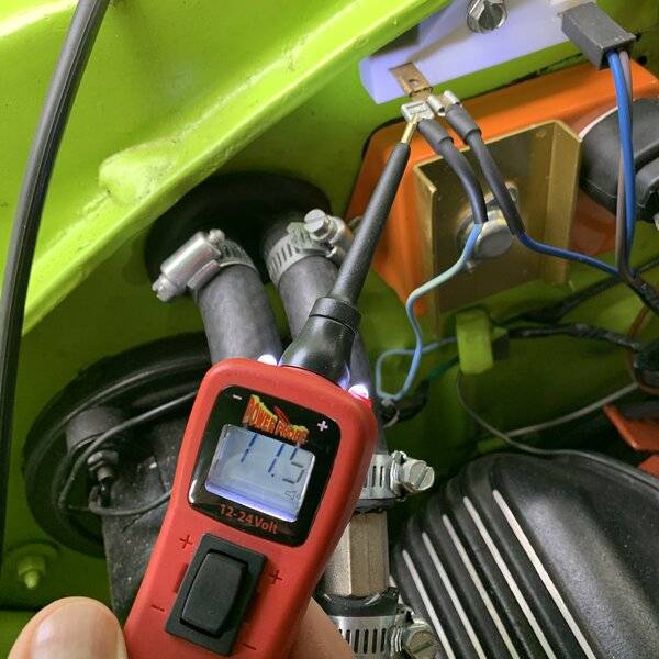

So I swapped my orange box For the blue box and it’s resistor. Went for a test drive, ran great for about a half a mile, then started missing and shaking like crazy. I limped it back home swapped out the old ballast resistor for the new, same problem. Then I put the orange box back on and it ran fine. However, now my engine off start position voltage at the coil is only 3.5 V, about 5 at idle and can rev it to 6v. I guess I just burned up a brand new $50 blue box, or maybe it didn’t have enough voltage?
Any suggestions?

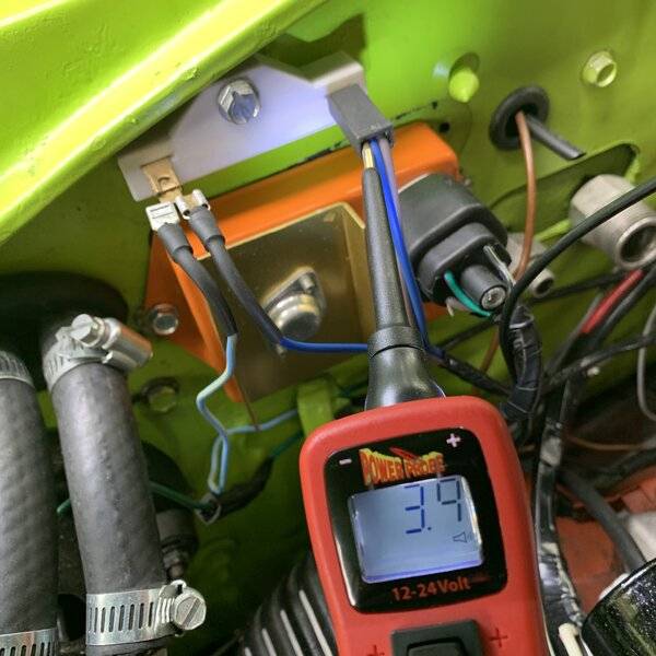

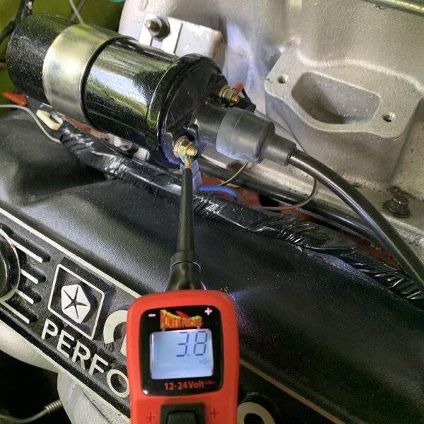

Any suggestions?

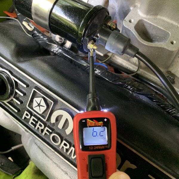

engine off, run position:
Engine at idle:

Also, my power probe’s + sign flashes red at idle at every terminal. Is that right?

6.2 Volts at idle + side of coil with that ballast is normal
Depending upon resistance of Ballast - 6 to 9 Volts running is normal

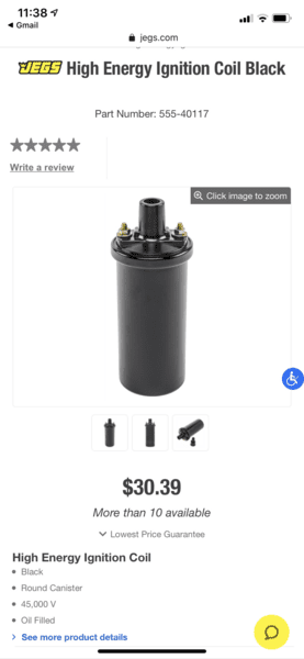

Jegs.

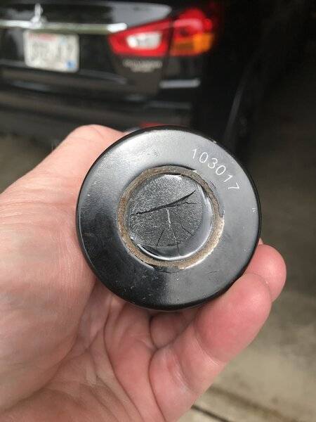

Bad coil. Boom. Fixed And runs great with the blue box and idles better too. I’m glad I chased that rabbit down that hole. Thanks for all your input.

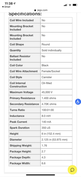

Also that Jegs coil has interesting specs with a 1.4 Primary and 4700 Secondary
And your testing wasn’t even close to those specs

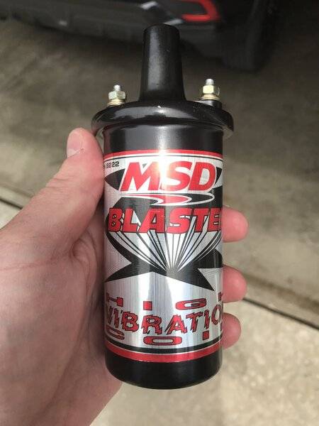

MSD Blaster Epoxy and an Oil filled with there .8 Resistor - Both Junk
