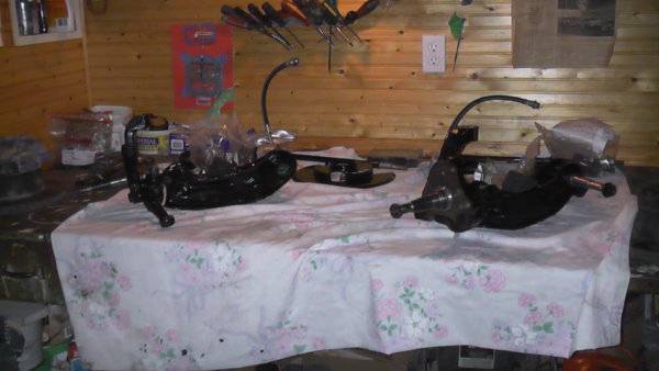

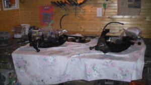

Went at it for a tad today,and this is wear I am at so far today,too my surprise the bolt that attaches the spindle to ball joint is drilled for a cotter pin,never notice that on my A bodys.
...when grandma sees you swiped her table cloth.....she's going to wup your *** son....
