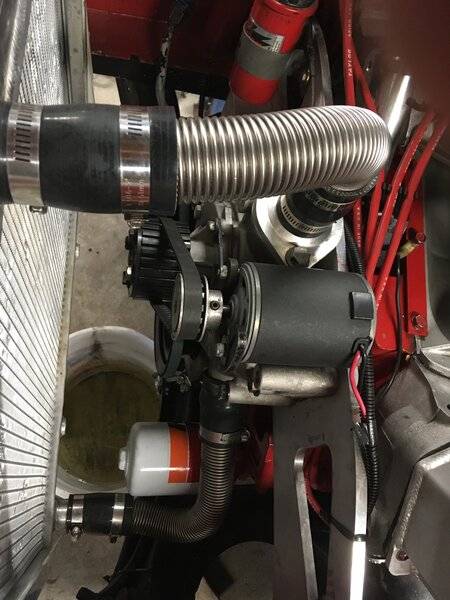

You buy the pipe and proper reducers of whatever size you need.
http://www.siliconeintakes.com/intake-pipe-reducer/
