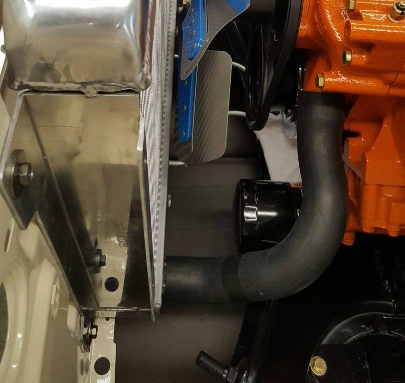

Wondering if anyone knows a part number for a 440 engine and a 22" radiator's lower radiator hose? The parts houses pre molded ones sit on top of the oil filter and has an odd angle. Water pump dumps drivers side and lower rad inlet is also drivers side.
The 22" and 26" should be the same. I ordered a Dayco 70679 which is touching my filter too but the bends and length seem correct. Mancini Racing has them as well but they are $52
Many times they need to be trimmed to fit right
I bought this one through Summit. Continental #60659 1- 3/4" both ends, doesn't come in contact with filter.
https://m.summitracing.com/parts/cel-60659
I'm trying to find the right one for the top! Not the squirrly one like on the Roadrunners but the original one, twisted "S" shape.
Same issue I have. The current hose I have on is half flattened against the filter right now :mad: That one looks like it'll work well. Amazon has is for $19.49 and free shipping. Rockauto is $12.02 but I didn't check the shipping charge. Shipping for me from summit is $6.95 so that $22.92.
