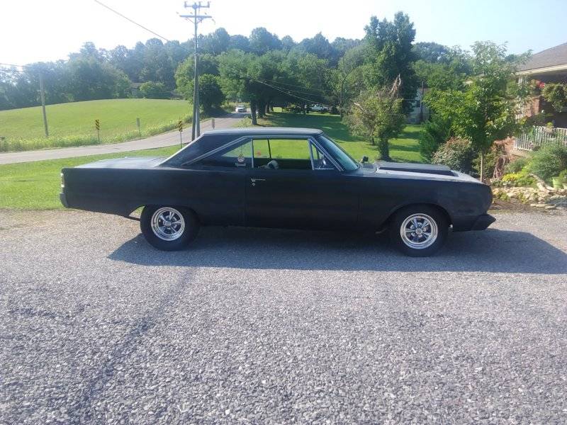

Well first off I want to State and say something I do appreciate all the positive responses and from those of you who have taking this endeavor or have made changes to your car that you felt will fit or that you like and I do appreciate the comment about how nice my car looks it's not that I want the car lowered really far I just want the wheels down or should I say the wheel wells down over the tires a little bit more to give it a More level look that a jacked-up look in the back I know the picture looks good but when you're in front of it it's a little bit higher than what it looks and I like mine down a little bit more but I do appreciate it very much all the responsive and please keep them coming with your great ideas and also if you have any pictures of before and after would be awesome

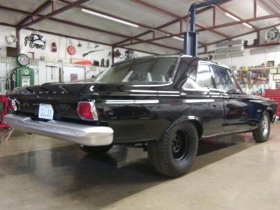

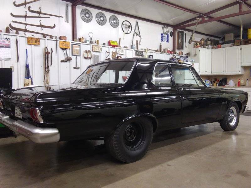

Speedway sales a nice aluminum block with a 9/16" centering pin. From 1/4" up. The ss springs and 30" tall tires was a little too tall for my liking. I installed 1.5" blocks on my '65 Belvedere and it dropped the car 1". Just make sure the "U" bolts are torqued and surfaces are clean.
Build what you like. They can build what they like.

Boy that looks good I like the way your car sets man looks nice I like that I like that old super stock look looks awesome

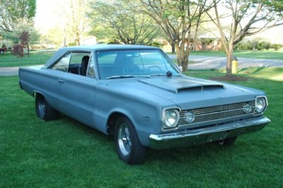

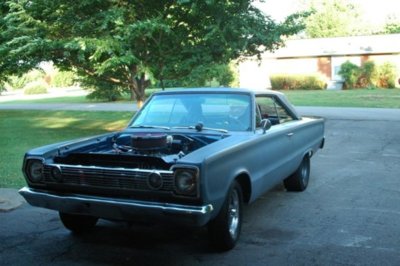

I agree sir with what you said and i was going to raise the front up 1" i just feel that with Super stock springs its going to need the blocks to come down some.. Before i had a little smaller rear tire height wish and a tall tire up front and it looked good. here are a few pics
