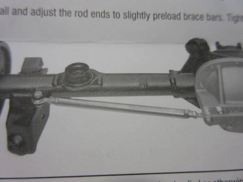

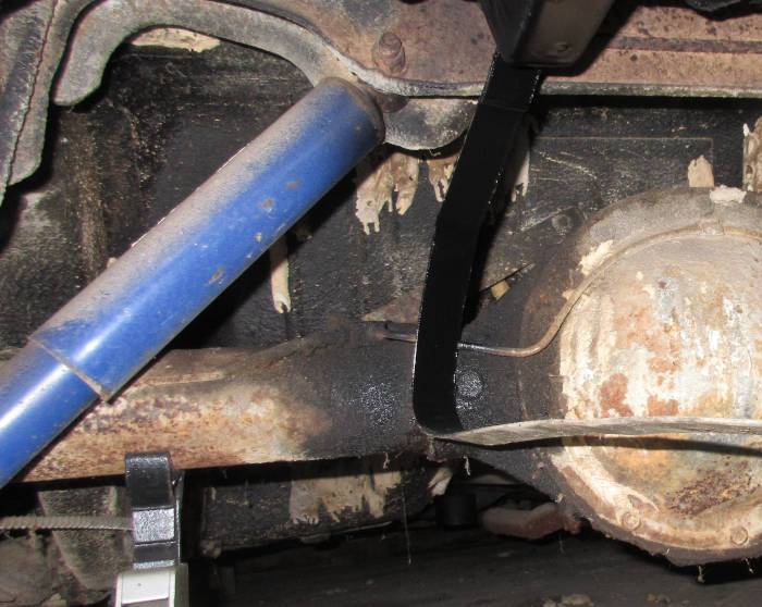

I'm looking at the instructions, and the shock placement on the Charger, and it sure does look like the shocks are going to be in the way of the brace. Am I missing something? Maybe this brace is compatible with an A or E body, but it doesn't look like it's compatible with the B-body without significant suspension modifications.
I was also thinking the outer end would go to a U bolt, instead of having a tab welded on. Maybe it could be? It seems like the tab would be in the way of the U-bolts on our cars.
That brace looks like it's for a coil spring app only, and I can't find anywhere that says it fits a Mopar. Do you have the cast aluminum cover it needs for your 8 1/4?
Yes, I have the cover. We talked about the brace kit in this thread Link. It looks like the brace will fit the 8 1/4, but not the 8 1/4 in a b-body with the stock rear suspension. Is there another brace kit available?
