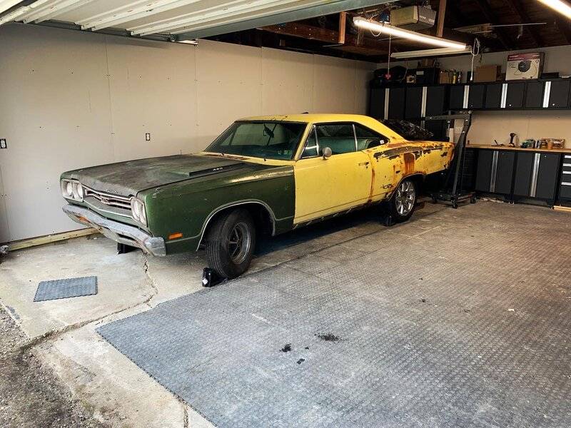

So, with all the info you’ve given me and from the other comments I guess it’s safe to call it a Track Pack car, since by default, a 440/4spd was a Track pack car at minimum.
I don't know if they called it a track pack in 68 but it is the track pack if that makes any sense.
Ok so I feel like an idiot.
It just clicked in my head how the codes work….
So I’ve been trying to match codes to my “stamped” numbers and nothing freaking matches.
But literally the light bulb just went off that
Line number + stamp number= code.
For example at the top of my BS, for the trans, it’s line number 39, then stamped with a 3. Meaning my code is 393.
And according to the code guides I found, 393 is the code for an HD 4spd trans.
Decoding this just got a hell of a lot easier
Code 83: 440 4bbl HP
Code 393: HD 4spd manual
Code 406: Dana 60 3.54
Code 408: sure grip diff
Code 478: 11 HD brakes
Code 648: Hemi suspension police handling pkg
Code 580: magnum 500 14in wheels
Code 521: tinted glass
Code 415: AC delete
Code 564: buckets no headrest
Code 765/965: hemi rear spring assy
Code 626: HD battery 70amp
So the car is exactly what I thought it was.

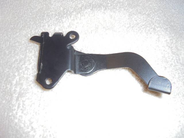

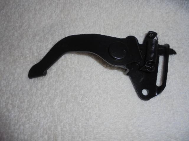

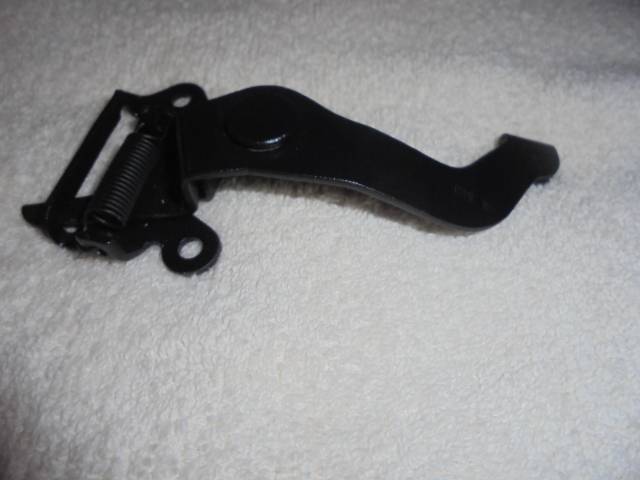

I was wondering if you could verify a hood release latch I have. I'm pretty sure it's for a 68 GTX/Sport Sat. Your car looks pretty much unmolested. I have attached some photo's. Either way could you send me a couple of shots for reference.
Thanks
Thanks

Absolutely, I’ll take a look when I get home. The car does have 69 fenders and grille but the core support is original so I would assume the latch assembly is all original as well.
Yes this makes perfect sense. “Track pack” wasn’t a real “stamped” package until 69+. But for all intents and purposes, mine is exactly what a track pack is.
Its like in 68 someone custom built a track pack with the sales options. And in 69 Chrysler went “hey let’s just sell that combo as a package”
But I see a lot of 68 GTX cars listed for sale as a “track pack” so it must be accepted in the community to call it as such.

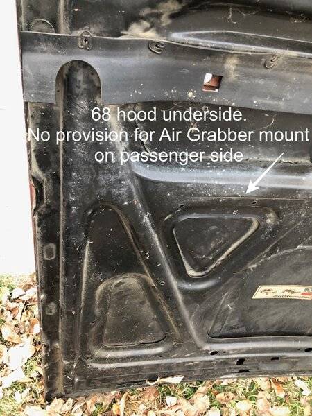

A little off subject, but do you know if there are any differences between 68 & 69 fenders/hood other than the marker lights?
a previous owner at some point put 69 fenders and grill on the car (probably just what they could find) so I was curious if it was worth sourcing correct 68 fenders.
the hood I have no idea if it’s 68 or 69, when I look them up online they look the same. The car I believe was green from the factory and the 69 parts they used are also green so it’s hard to tell what’s what lol.
I can't speak to the fenders but... the 68 hood does not have provisions for the air grabber system on the underside. The 69 has a small attachment point on the passenger's side. The tops look the same. The 69 has the filler piece to help match it with the 69 grille.

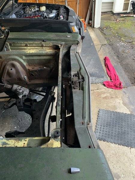

Looks like you have a 69 latch tray with the correct lever for a 69. The fenders are the same except for the side markers and the part were the rubber bumpers for the hood adjustment are. That part is attach to a 69 fender. It was probably removed to attach the fenders. They can be drilled out. The hood has the correct 68 inserts. The difference from 68 to 69 hood is a 69 has the underside cut out under the insert for the air grabber option.

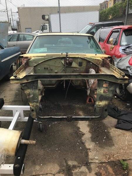

Ok so then it looks like it’s just 69 fenders and grille, with a 69 grille support and latch?
But the hood and everything else appears to be 68 then? Like I said I’m trying to decide whether it’s worth taking back to 68 parts.
And would you say this rad core support is the factory 68 rad support? As I work towards fully documenting this car that is a big deal since the core support should have my SO# which I can use to verify my BS and tie it all to the car.
Another big score is I managed to track down a previous owner who claims he should have the fender tag AND that his buddy has the original #’s matching engine! I’m trying not to hold my breath but man that would be huge. Again, thank you everyone who has helped me navigate this new venture.
Looks like they removed the hood bumper plates on the 69 fenders. If the fenders are solid and straight then all you would have to do is weld a couple of patches over the 69 marker holes and redrill the round 68 holes in the correct spot. If you wanted to put the correct 68 GTX grill back in you would need to replace the upper latch and grill support with a 68 one along with the grill and bezels from a 68 GTX or Sport Satellite.. The lower bumper to grill filler should be the same.
Awesome thank you! Just the answer I needed. I quite like the 69 grille over the 68 and would keep it if I’m able to make everything else 68 correct. But if keeping the 69 grille meant running a whole 69 front end I’d change it. And digging through the forums I was getting mixed info, some saying you had to run a 69 core support, whether or not 68 & 69 fenders are the same, etc.
But you hit the nail on the head. I was able to confirm through a previous owner the hood is original. I was able to match the body stamps on the rad support to my BS. And now that I know 69 fenders are the same I plan on just welding a patch and installing the round markers.
So all will be 68 correct minus the grille and grille support. I’m fine with that and is easily changed back if I ever need to. At least I know a 68 grille and support can be put back in without having to source an entire front end.
