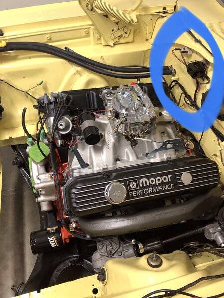

M&H are excellent. As others say, just 12v switched from ignition source is all that’s required (and a ground). I take mine from the ballast. Circled in blue shows the red wire for the choke. It wouldn’t have mattered which side I took it from as my ballast is bypassed for msd. I just chose that side because it balanced how many wires were coming from each side.
