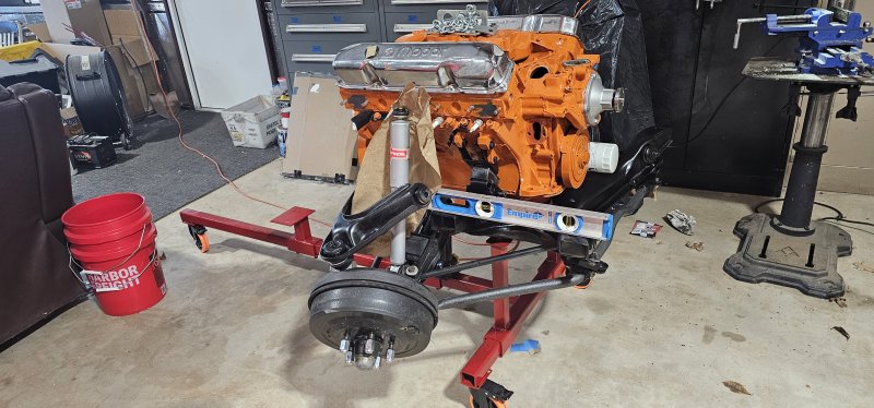

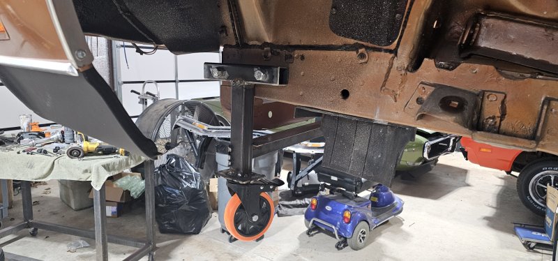

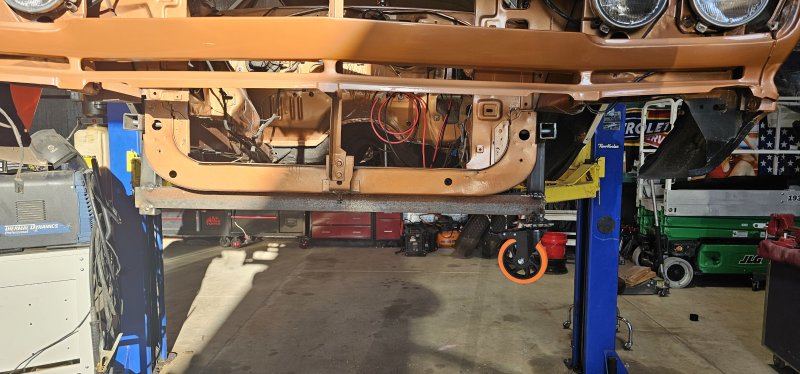

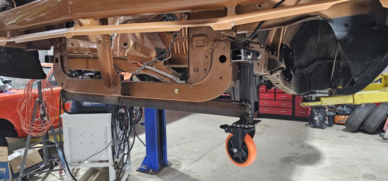

Made a custom front end dolly and K member dolly.
sixsixvette
8:04 PM
Jun 7, 2024
112
152
Norman Oklahoma

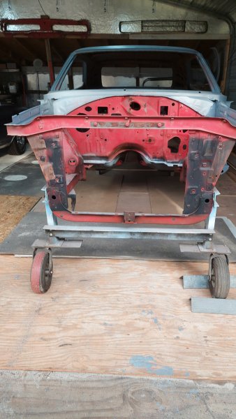

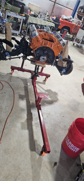

Built the K member dolly along the lines of others I have seen on here. But built my own front end dolly so I could roll the GTX off the lift while k member was out. Waiting on Amazon to deliver another wheel, and then finish welding her up with a coat of paint. What do you guys think? See any concerns that Im missing?

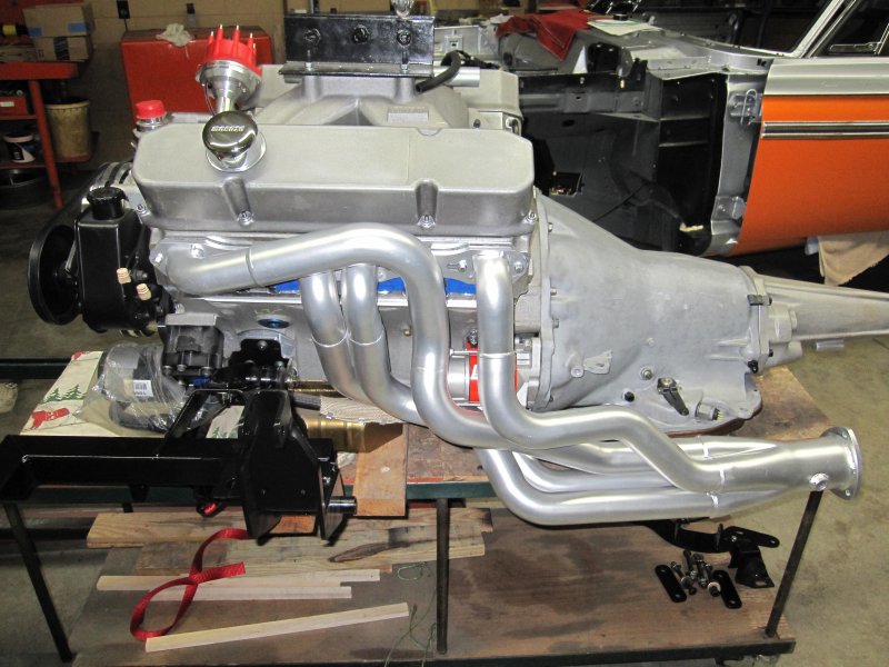

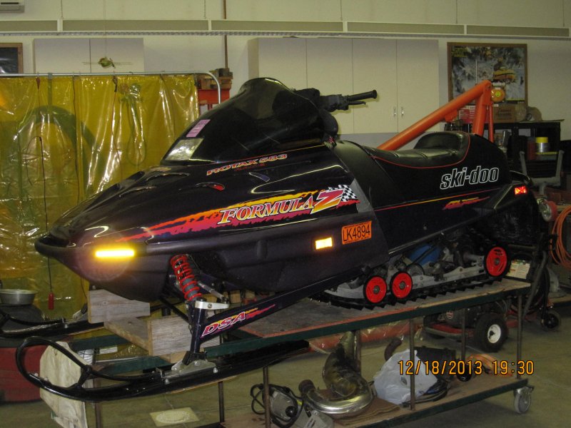

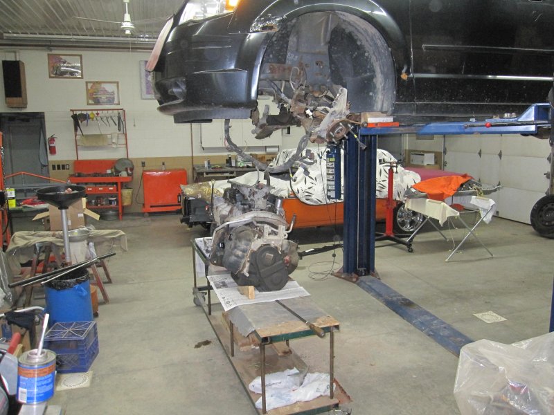

I made a cart to roll around my snowmobile for service and used it to install the engine/trans into my 65 and later to R&R the 3.8 from my 2008 T&C minivan.
