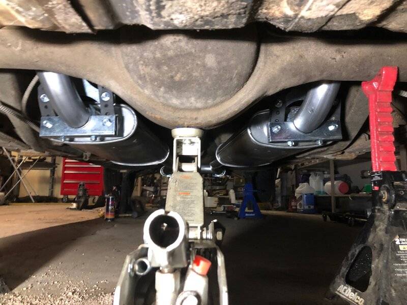

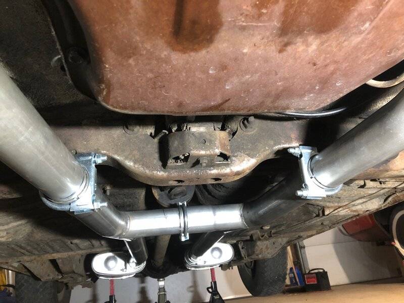

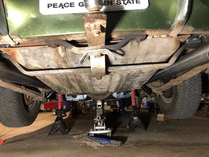

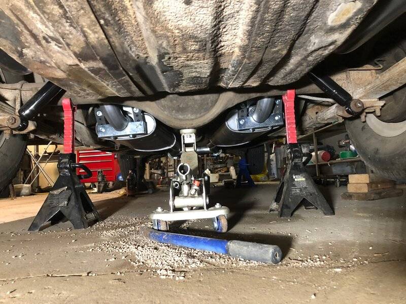

I ended up going with TTI. Thanks for the replies.
