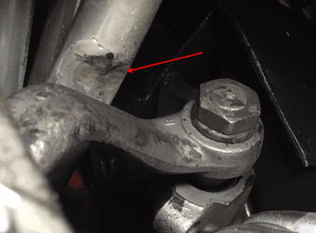

Found today that the pitman arm is hitting one of the tubes on full lock.
Also, despite the Magnum Swap site saying that LA headers bolt right up to a Magnum there is a slight mismatch to the ports.
Is there a fix to the pitman arm hitting the tube (other then denting the tube further than it already is)? It has new engine mounts. Is it possible the engine is slightly off centre?
If I went for new headers to fix the interference problem, can LA headers be made with Magnum exhaust flanges to fix the port mismatch? Is this something that TTI, Doug's , Hooker, etc will do?
If I went for new I would probably consider shorty style headers to eliminate the tightness around the steering area. There are shorty headers made for Magnum motors, would they work?
Anyone with any experience on this?

Header hitting the steering linkages?
Dent the tube.
The engine should be slightly off center. That is normal and correct.

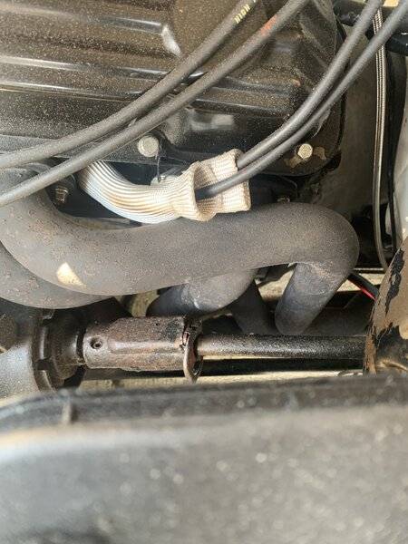

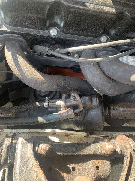

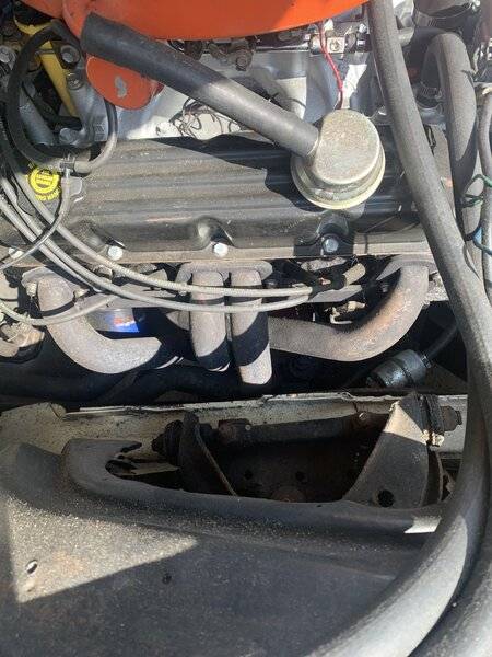

Hooker Super Comp pictures in a ‘79 B body.
Plenty of room around the P/S box and steering shaft, Familiar design on the passenger side, just a larger tube. Very good ground clearance. With these headers, you do not have to take apart the front steering linkage is to install or remove them.
View attachment 972895 View attachment 972896 View attachment 972897 View attachment 972898
Wow. Tight fit. #1 cylinder looks very close to PS hose fitting. Doesn’t hit? Maybe best answer for me in short term is to provide a little more relief in the tube on mine. Will be putting in another steering box in the next few months, don’t want side loads to impact sector shaft.

I bought the car with these headers and have been slowly working through issues on the car. Unfortunately the previous owner(s) didn't identify the interference, or chose to live with it. I have had knocks in the front end to which I have re-bushed the whole front end and new shocks all around (ball joints are tight). Despite this fixing a lot of the issues a couple of knocks persist, one that actually appears to be bad door hinges on right side (you helped me on that one in another post), and the other I have now discovered is the pitman arm hitting the header tube near full lock. I actually found it by seeing the headers / engine move sideways up to a couple of mm when the steering was turned towards full left. Fairly sizeable dent in the tube already.
No, it only looks close. I’ll try for another who later this evening after work. The f your engine mounts are shot, it’ll hit.
Fair call on the engine mounts. Mine are a couple of years old. I checked engine location measurements this week against that of TTI recommendations and everything comes up OK. When I change the steering box in a few months time I will have a good look at what is going on then. Not sure if new pitman arm will have a different "curve" to it. Or with the headers out it may be prudent to change the profile of the tube it is hitting.
