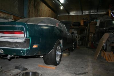

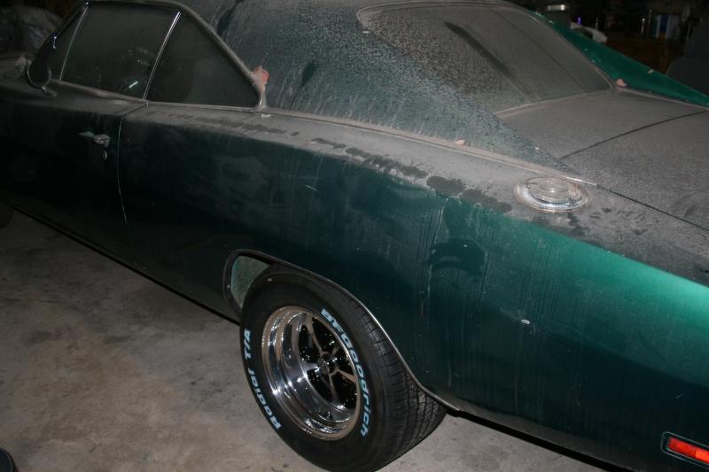

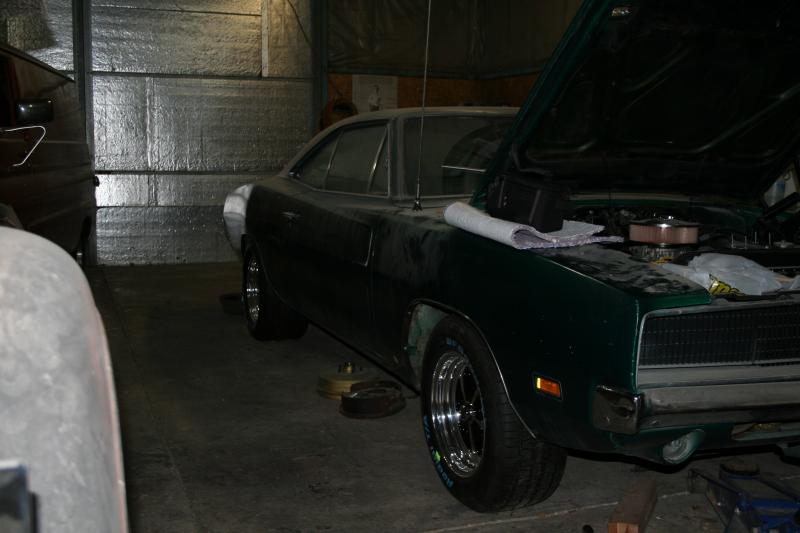

Here's a set of AR500 from American Racing front-15X8 4.5" bs with 245/60/15 and rear-15X10 5" bs with 295/50/15. I just finished installing four wheel disc brakes, so don't mind the mess. IMG_0395.jpgIMG_0396.jpgIMG_0367.jpg
Car Nut your Charger looks like mine did 8 years ago. Those wheels look great. Why did you decide to go with Aluminium Magnum 500's? I do like the idea of a lighter wheel and never having rust or pitting. Do you know what the weight differences are? What disk brakes did you go with? Thanks
GetX'd thanks for the advice, I was originally leaning toward a redline but after seeing those Goodyear GT polyglass tires I think I might change my mind. They are a very tough looking tire, and I had no idea that they were original equipment on the R/T Chargers. I do have room for the 15x10 but I think 15x8 will be a better fit for the L60 at the same time saving some weight.
The biggest reason was rust and I got a deal on them, $202 ea. for the rear and $187 ea. for the front. You can get them in any back spacing you want and reverse centers if you choose. They are lighter, close to 10lbs on the rear and 15lbs on the front lighter. The disc brakes are lighter too, but more importantly they're safer. The kits are from Baer, front are #4141046 and rear #4142001.

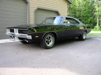

I used 15x10 with 295/50/15 on the rear and 15x7 with 245/60/15 on my Charger. I think this combo looks great on our B-bodies.

I'm pretty amazed at all these 10 inch wide rear wheels with 295 tires. Is it safe to say that this combo will fit any B body?
Hunt2elk, what offset and backspace are you using on that back wheel???
The rears have a 5.25" backspace. A lot of guys are running 5.5", but on this car the tires rub on the inner fender while turning and going up an incline with 5.5". Dodge cars have more room than a Plymouth in the rear wheel area. I have a 69 Road Runner that I would love to use 295's on, but there is no way without some major modifications - although some guys on here are running that combo on their Plymouths. Do a lot of measuring before ordering and if there is any doubt, go with more backspace as you can always add a spacer - within reason of course.
