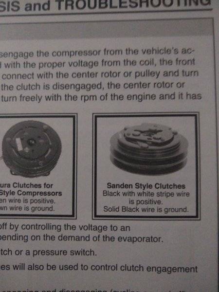

Do you happen to know a Sanden PN or OEM application for a 2 groove pulley compressor?
Sanden sd 508 dual v grooves. Should be able to get it at vintage air. Freightliner has them also have the serpentine style also. Just ask for hd model.
Here is a pic
