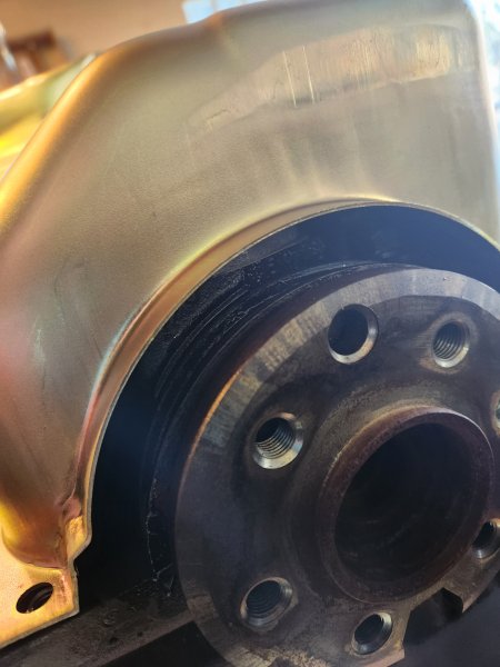

I have a 318 magnum and I got a 318 LA oil pan since I could not find any mid sump pans for a magnum. (I need a mid sump other wise it won't clear the steering bar) problem I'm having is that at the rear there is a huge gap. Is there anyway to fix this? Could I get a LA gasket and will that fix it?
An 'aftermarket pan' would be my suggestion...
