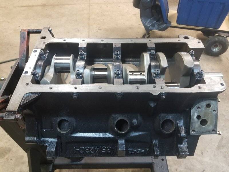

I used the cross bolt main caps, and I really like them. I will use them again on my next build.
But...
I bought mine from 440Source, not bad mouthing the company as whole, but the machining on the caps was very sub-par.
Luckily I'm a machinist and I could requalify the surfaces to make them useable.
If you go with cross bolt caps I would recommend a little higher quality ones.

Well I don't know how much it would cost, the shop I work at isn't an automotive type shop, more " Tool and Die ".
I fitted the caps and bored them a little undersize on the Boring Mill and paid to have it line honed.
