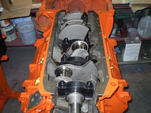

This was the last wedge I was able to machine for myself when I was still building engines. I just went with the 2 bolt program caps. We've never ran this one yet, I may girdle it before I do.

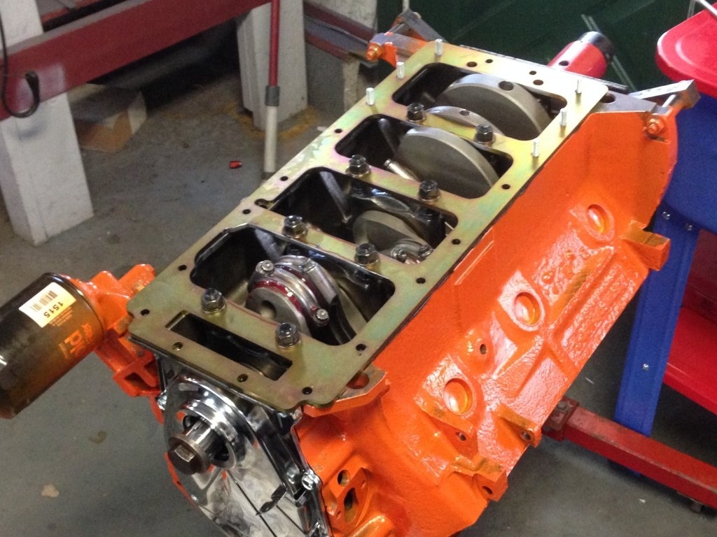

I'm sure that there are all different opinions on these main girdles effectiveness. I always felt that to rely on the oil pan nuts themselves to tie everything together could be improved on. I started fastening the girdle down with 3/8-16 flat head torx bolts a couple years ago when a customer would bring one in to be installed. It takes a little extra time but it definitely locks everything down to the block. Here is a pic of the last one we did. It only has 3 fasteners down each side instead of our normal 4 because he was nervous about losing an extra pan bolt.

View attachment 399943 I'm sure that there are all different opinions on these main girdles effectiveness. I always felt that to rely on the oil pan nuts themselves to tie everything together could be improved on. I started fastening the girdle down with 3/8-16 flat head torx bolts a couple years ago when a customer would bring one in to be installed. It takes a little extra time but it definitely locks everything down to the block. Here is a pic of the last one we did. It only has 3 fasteners down each side instead of our normal 4 because he was nervous about losing an extra pan bolt.

For the job in the pic $500.00 That includes cutting caps if needed, deburring, shimming, installing the torx bolts and line hone to size. I bought a chamfering cutter with the same angle as the underside of the torx bolt to get a nice fit and lock the girdle in place. Once the girdle is shimmed to fit nice on the block, the main caps are torqued down. Then we drill, tap and chamfer each hole and install the torx before moving onto the next hole. Before this job the torx were put in line with the #2&4 mains so there were 8 total fasteners locked into the block. Sorry to say but these have all been street strip guys that don't put a lot of time on their stuff. Wish I had one on a good higher powered bracket car that would come back for freshening every other year so I could see how things were holding up, but that's not the case.
