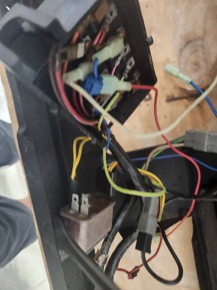

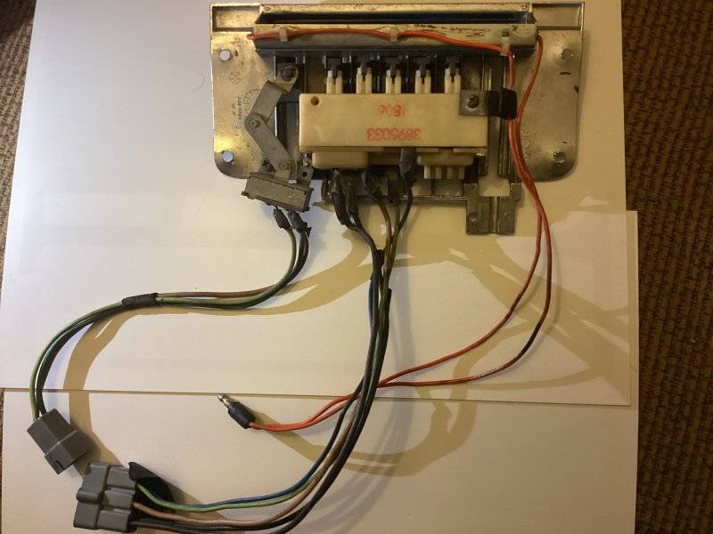

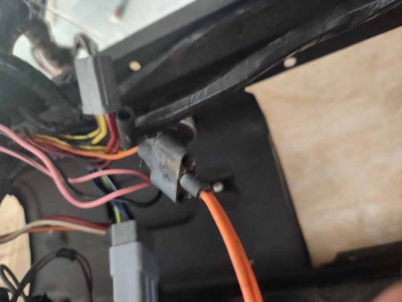

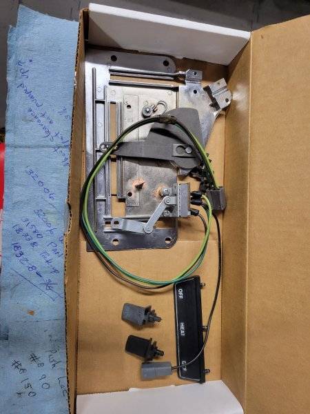

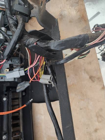

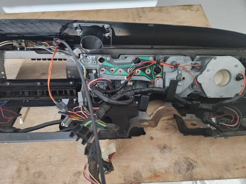

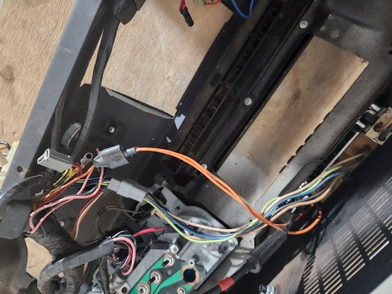

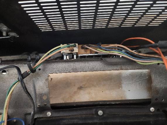

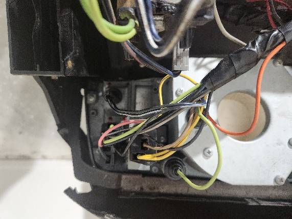

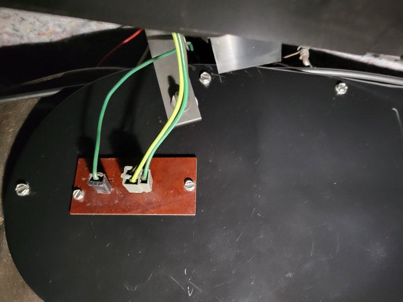

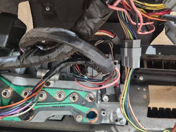

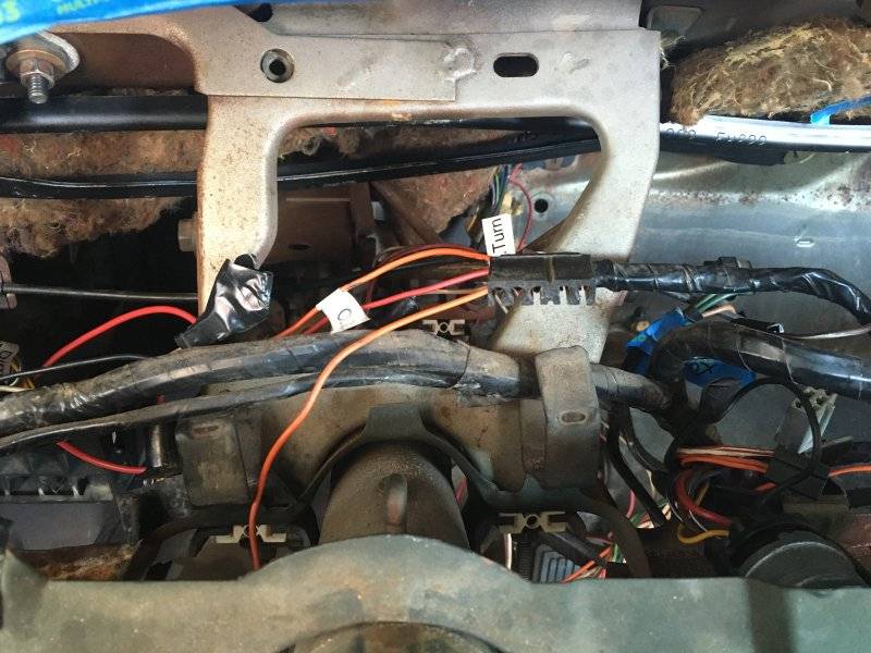

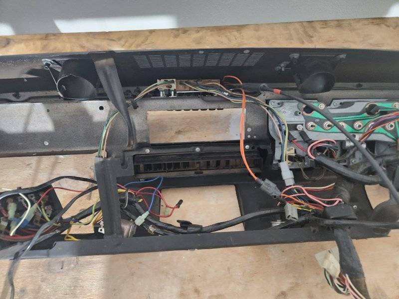

Dont know if this helps 70 charger
Thanks DaveK. I would imagine they're pretty close and since you have the same car.I do, (Bee)I was hoping you'd chime in. Let me zoom and see. I already plugged in the bulkhead connector and am working my way from there. I think I have most everything built.out on the dash so I'll hang it on the bolts and work from there...

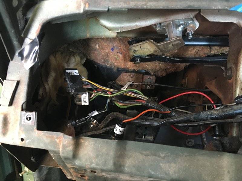

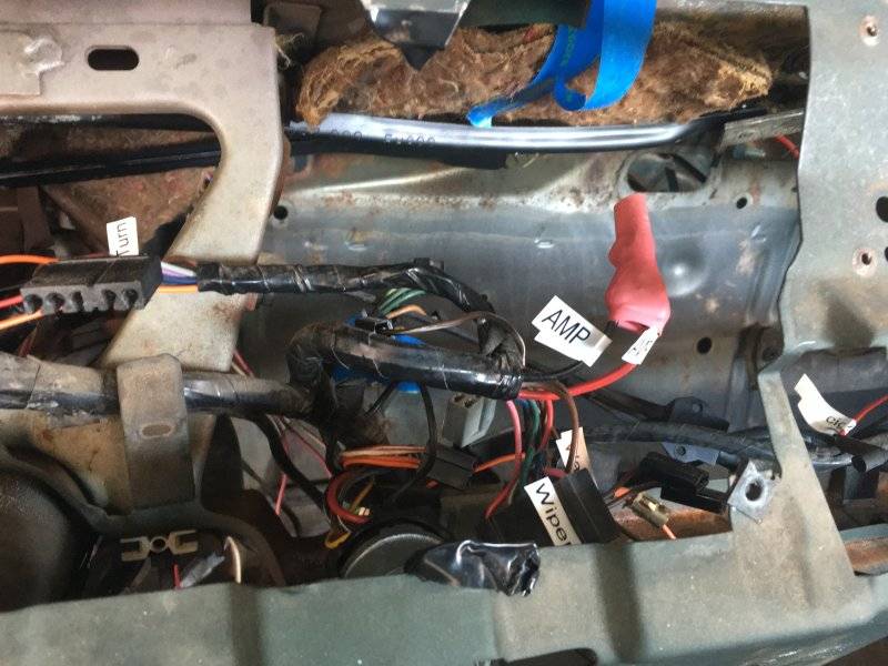

My 70 Bee I did with the dash in. If its a new M&T harness you Will have extra plugs.
I hope it's a nice day everywhere to be working on our cars! It is in Florida, even tho it's 90! My question....like so many of us that have committed to new harnesses in our 50+ year old cars, I have done the same. I bought M&H harnesses and the front, rear and engine harnesses are in. My problem with my dash harness is the routing and use of the behind dash bundle clamps. Yeh, I know ...where's the pic I took when I pulled the original out? Well, that was 23 years ago and it sat for 20, stripped down. Now that I'm putting it all back together with the resto I've done, I can't remember how it actually lays out under the dash so it won't interfere with the wiper linkage, the vent cables, speaker wires, etc. Does some have or can take a pic of how the main bundle is configured back there?
68 Charger.
Pics looking at dash from left to right if I downloaded the pics in the right order. Original wiring.Some labels are on sockets.
I also installed M&H not sure if I have new harness pics.
Thank you guys. I'm pretty sure between BD and Dave, I'll be able to manage. It is a new M &H and I do also have the classic wiring color schematic to use. Good thing they are matching color coded on the new harness. I'm gonna hang the dash assembly on the bolts tomorrow.and start connecting. Take my time and see what happens!
