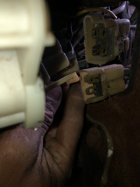

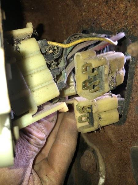

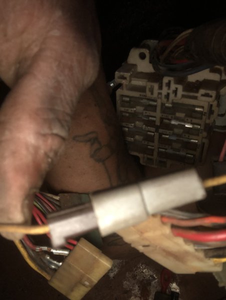

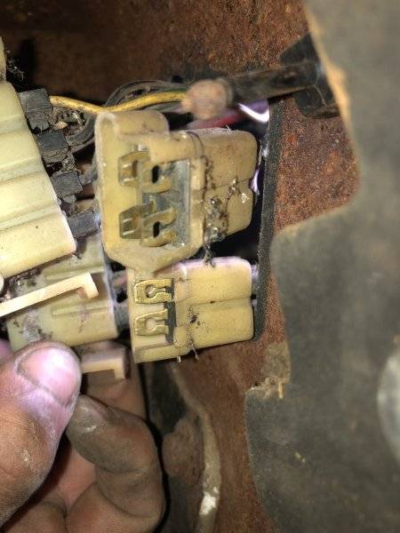

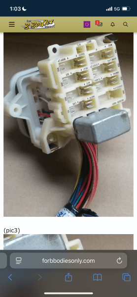

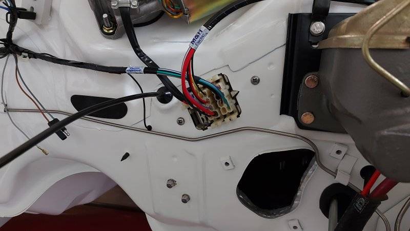

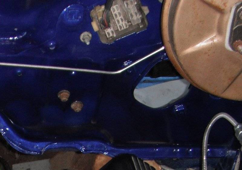

Does anyone have a picture of the main wire harness as orientation for mounting through the firewall near the pedals. There are two large brackets one with fuses and the other without. Pretty sure they stack on each other but once again I did not take photos on removal. Here’s what I’ve got picture wise last few are not the main but still could use positioning and direction on those as well. Trying to fire my engine for first time soonish! Thanks
Orient the block with the wires so the plugs face into the engine compartment and the two 4 circuit plugs are towards the passenger side. The block should have a triangular shaped pin that sits in a notch in the hole through the firewall. It should also have two mounting screws on it that will protrude into the engine compartment and get secured with nuts. The other block clips on like in your second picture but with the horn relay (metal can) to the top.
