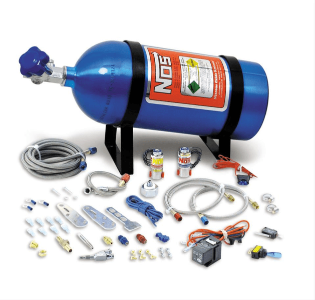

or N2O is cheap, a 150 to 200 shot is pretty easy, not a real engine killer
if done properly

if all else fails Boost or N2O
