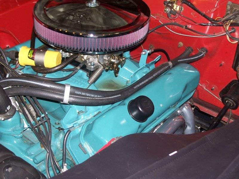

my 413 was out of a Chrysler 300F....and bored...no problems BUT It might be a different ball game?...the heads are
cast #2206924 .....361/383/413/426...........I have stock 4bbl manifold with Holly 750.DP/ mechanical secondary s....runs VERY well...chrys purple stick 484///282.....headers..
