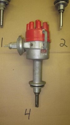

i have eng harness with positive lead for coil,but where do i connect ground wire on distributor to go to the negative side of coil? i have condenser wire and connection to distributor.thanks
A simple length of black wire, with the right connectors on each end. Goes from - lug on the coil, to the screw/stud on the distributor. Same location the wire from the condenser fastens to.
Connectors on the wire...a loop on coil end, a fork at the dizzy end.
