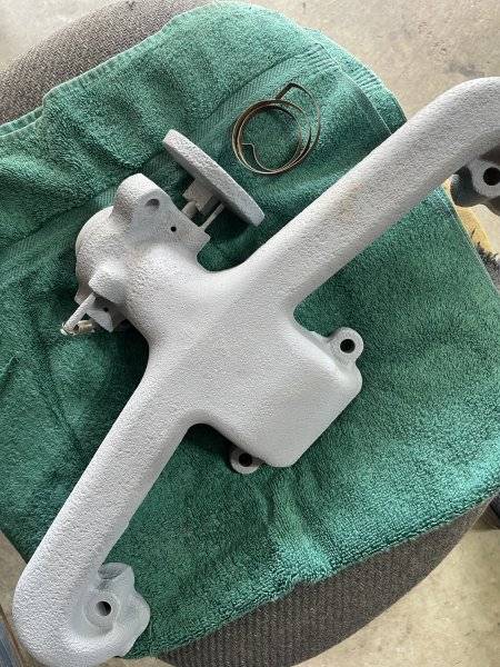

Gonna stay with original manifold for my 318 build. Is this flapper salvageable(coil seems outa wack) if so how is it fitted on? Or should I go route of dremel off and pipe weld?

You don’t want an operable heat riser. It will just rot out your right side exhaust pipe faster. I don’t see much point in making it operable and then wiring it open so that it isn’t functioning but if trying to keep everything original and functional then that’s an option. Neither of my cars have their heat risers anymore. They’ve been fixed.
I choose to keep my heatriser working. Not that the weather is cold enough here that it's absolutely necessary, but my choke is functional and works correctly. I only have one car that eats mufflers and it's not restricted to the right side although that one usually goes first. Most of my cars have muffler systems that have been in place for a long time and are the aluminitized hemi style mufflers. One example is my Superbird with the same muffler system for 25 years and the heatriser was restored along with the car. I also don't block off the heat crossover when rebuilding the engines.
It's not really necessary unless you are dailying it in winter in a cold climate. Remove and plug weld the holds. One less thing to fix/maintain.
Back about 1968, the "flapper" froze in the closed position on my 1965 Plymouth 318 poly. Caused the right head to crack. Junkyards had plenty back then. Torched the flap out, left the shaft.
Recently purchased a '63 with a poly. Low compression center two cylinders right side. You guessed it. Frozen flapper. Burned the flap out as in 1968. Bought a pair of 1966 heads. Prices sure have gonr up. Still need to get both heads a simple valve job after checking for cracks. Prices on machine shop work have skyrocketed too.
In a nutshell; get rid of it.
I get rid of them. Knock it all the way through with a drift and a BFH. If the bushing stays in tap it for 1/8 pipe. If the bushing comes out, tap it for 1/4 pipe. I have had them hang up too many times to consider leaving them in.
I was planning on keeping my flapper - 70 Charger SE, 373 HP, numbers matching in full restoration mode right now. It seems to be functional; however, I like the idea of removing just the flapper so it looks original from the outside. Thanks for the idea
I've done as simple as removing the flapper and leaving the pivot pin, or installing a bolt.
Actually less restrictive than the pin and flapper.

What vehicle does it belong to? looks like maybe a truck manifold with the center dump.
