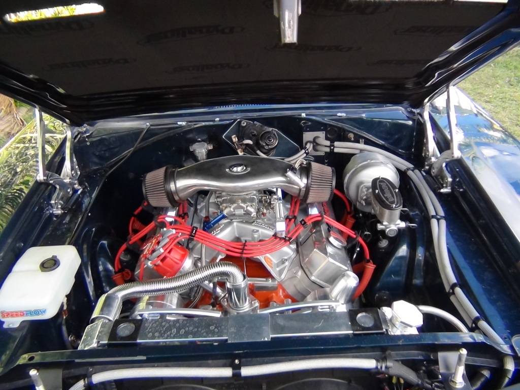

heres mine,
i upgraded to all 4 wilwood discs though, bolted straight on to firewall and pedal, i got it from magnumforce,com i think summitracing and mancini have similiar ones that bolt on also.
