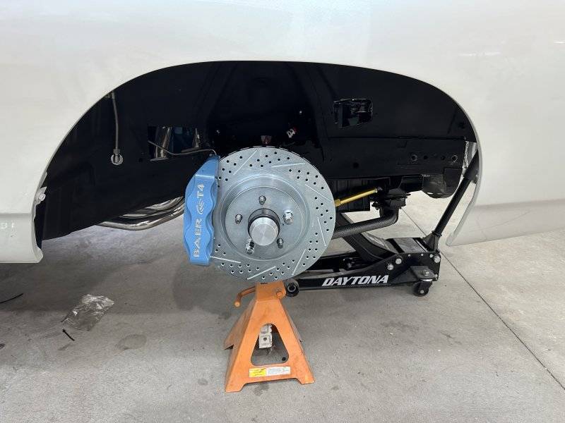

Baer 13" manual disc system on all 4 corners of my Bird. Would hate to feel what the power version feels like.
