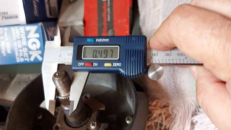

I measured the power steering column threads and got this.

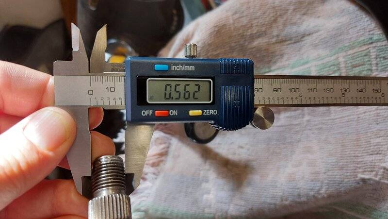

Then I measured the manual steering threads and got this.

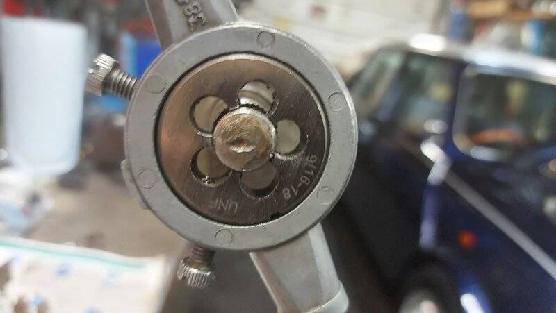

I would assume they are a 9/16UNF thread?
Turns out the thread size is the 9/16-18 UNF.

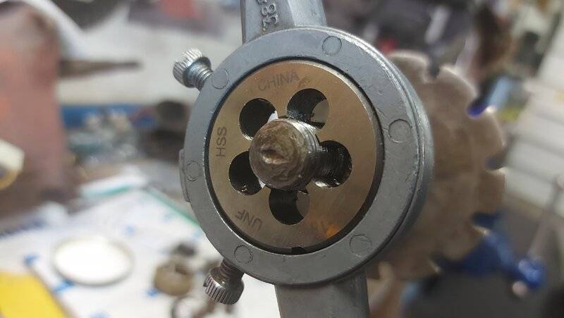

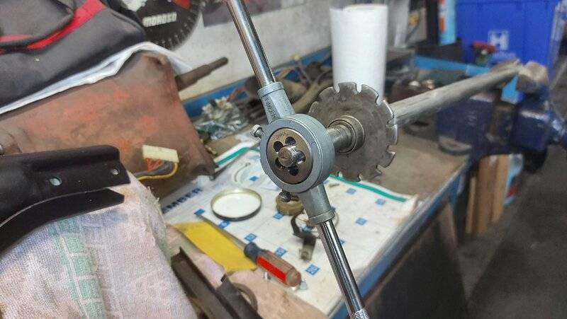

I was able to get a die and handle from my brother.
The whole job took less than a minute.
Cleaned up the threads all nicey nicey.....
