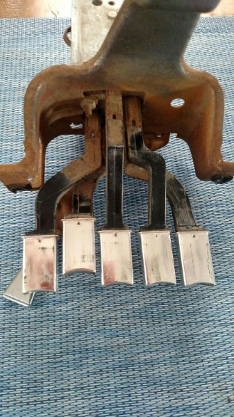

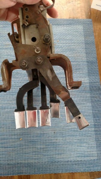

Here's what I found from my 330. It's before they were cleaned up for install...
There may be studs on the inner surface of the dash, and you'll just need to getthe nuts to hold it in place ? It's been a few years since I was under mine...
Thank you very much. I have the shifter with the buttons, but not that bracket in your pics that's nutted to it. I'll have to get my old bones under the dash and see if it's there. I appreciate your time man.

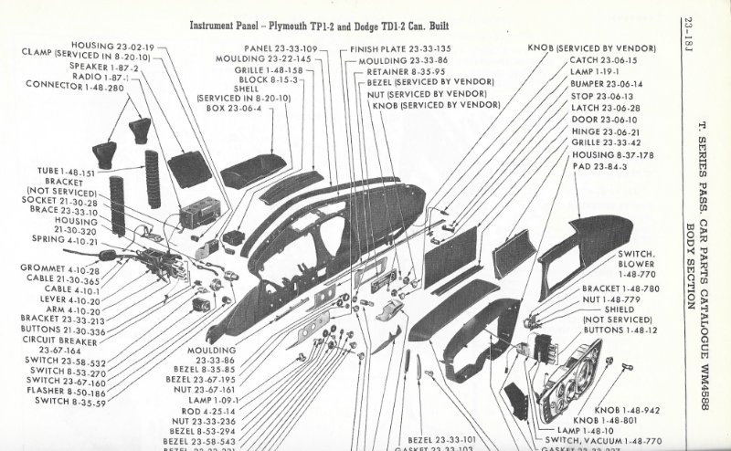

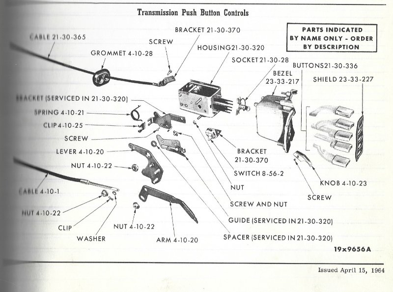

Hi Wally I must appologize as I've missed your request for assistance right back to spring! I've done a few of these conversions as I own two '63 Canadian built Dodges and one American built Plymouth wagon. The part you are missing is an aluminum casting that the button box bolts to. I've included two illustrations from the '63 canadian parts book which should help you sort things out! IF you still have issues do not hesitate to private message me. I reside in Manitoba.
Awsome sir! Now I can tell the parts guy what to get for me! Thank you.
