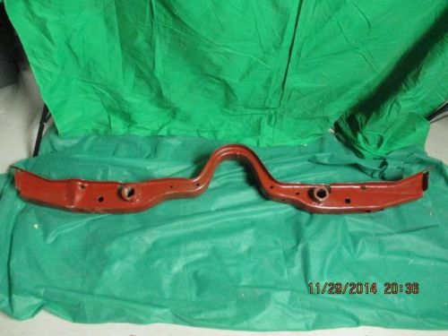

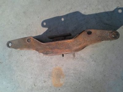

disconnect your exhaust and drop your centerlink, put a chunk of wood under the oil pan. and lower the engine to get your clearance. It's only about a 1/2 inch or less. cutting out your torsion bar crossmember is just ridiculous, Unless you mean this
That definitely needs to come out
This is welded in BTW
Also helps to remove the shifter body bracket and lickages from the transmission.

I have the exhaust unbolted and out of the way. I'm not sure what year car that the pictured torsion bar crossmember is out of, but I suspect it is an older car. In my 73, they changed the design so that the car had a softer ride. I do have that support in the car and it is permanently mounted as you describe but the torsion bars do not go through it. There is another support bar in place that is mounted with two bolts and rubber isolators that the torsion bars are mounted to.

I had to remove the Trans with that shifter plate mounted because two of the screws were gorilla tightened in the past and stripped out on me. Good news though, I actually got an easy out to work and they threaded right out!
The OP is pretty clear what year car he is working with. ’73 was the first year for the isolated front suspension on the B-body, specifically having an isolated torsion bar cross member separate from the transmission mounting. All references here to the previous model years design would not apply, different animal altogether. Don’t recall having to pull the torsion bar cross member to service transmissions at the dealers back then however and wouldn’t make much sense for the factory to design it that way. Never know though, find a FSM for that year, should spell out the steps necessary to remove the transmission as it was designed.
