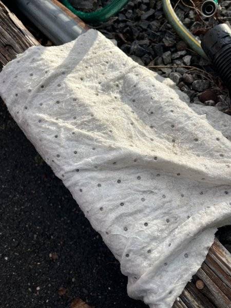

Removed my tank today…
Disconnected battery
Jacked up on frame with jackstands
Removed sender wire
Cut power & ground wires (in-tank pump)
Removed output fuel hose
Floor jack under tank
Removed both straps
Lowered tank about 4-6 inches, wiggled tank free from filler pipe
Lowered jack and pulled tank out

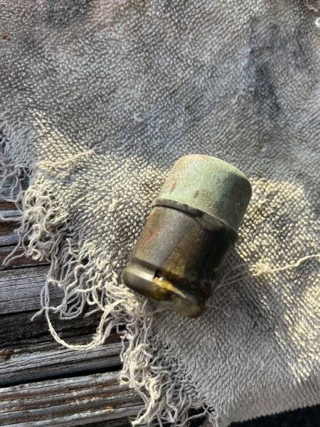

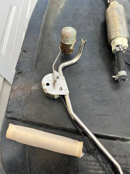

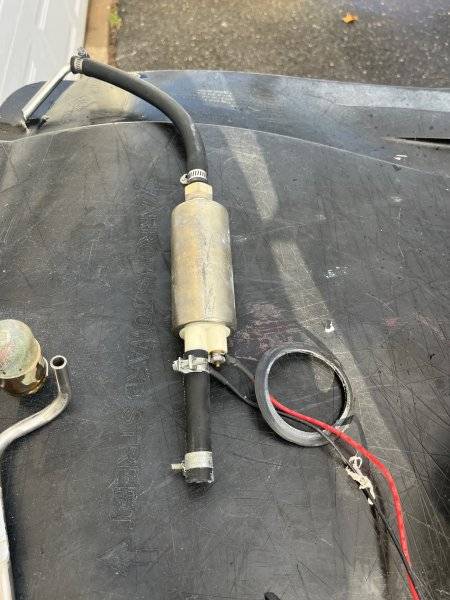

In my case, found multiple issues, pump disconnected , pickup filter off the inlet, sender float had a hole in it, and THIS CLOTH LIKE RAG all intertwined in sender and pump!!!!
I have no idea what this square rag like cloth is in there for! IMG_7734.jpegIMG_7735.jpegIMG_7738.jpegIMG_7739.jpeg
I have no idea what this square rag like cloth is in there for! View attachment 1937069View attachment 1937070View attachment 1937072View attachment 1937071
