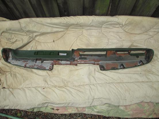

the map light insert and holes will straight match the dash pad screw provisions.
BUT HEY! I have seen some 71s without the dash provision for the map light insert! the dash pad must get a recession on dash pad for it, to be able to install it.
Here is a dash pad upsided down and you can see the recession abive the cluster area

So yo dash is not ready for the insert, but flat without any recession/provision on pad. Pretty sure a very early 71 production?
you have two options… forgett about add the map light or change the dash pad.
