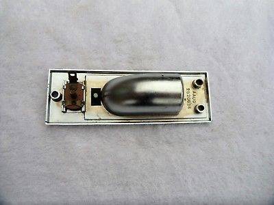

Hello, how does the map light switch attach to the map light base on 1970 coronet r/t. What holds it in place? I see where it is suppose to fit, but does not stay in place. Thanks for any help or pics would be great.
The switch is held in with 4 tabs. If they are missing some epoxy should do the trick.
