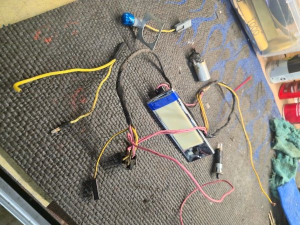

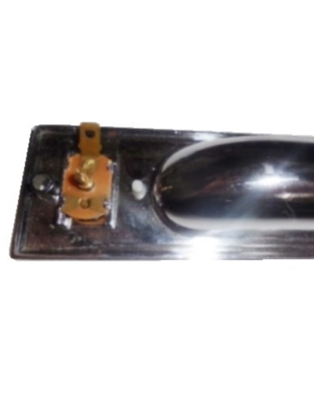

Any proper way to test the switch while i have the map light out of the car?
Thank you
I bench check the switch with 12v power supply. it should turn on in both position of the switch. By the door and turning on manually
you could also use an Ohm meter.
