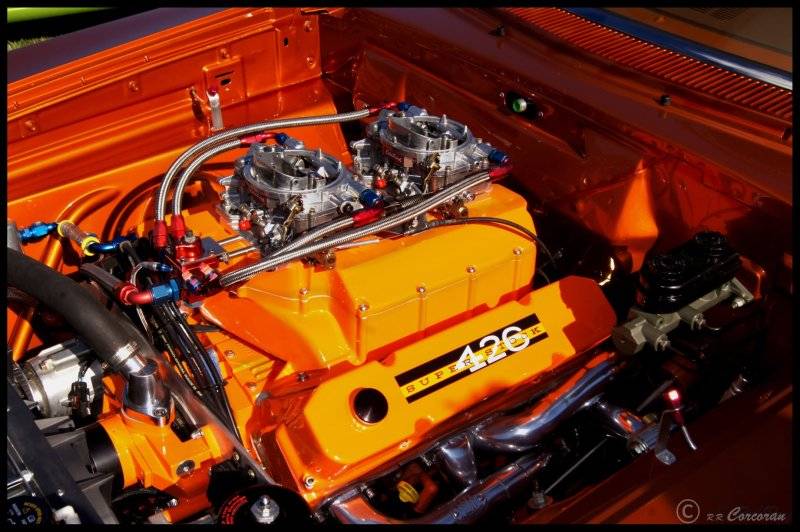

I mask the intake. The exhaust ports get stuffed with towels. All my aluminum heads have been painted. The Indy logo is even filled with bondo, Been that way 10 years.
