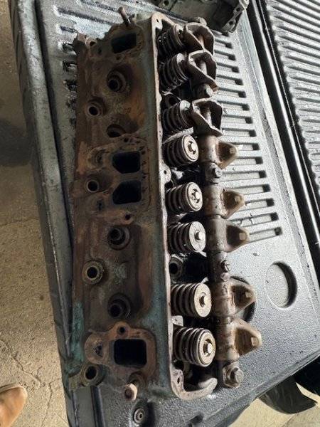

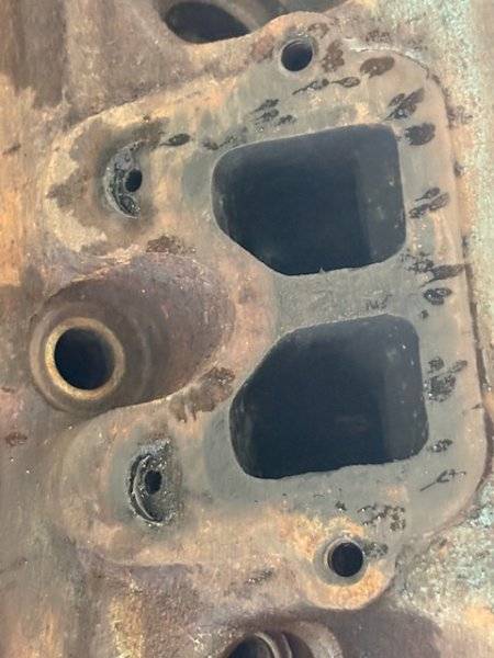

After 20 years the 318 in my 69 Sport Satellite finally gave up. It was a good run. I've pulled the motor and ready to go to my buddies shop. I have a set of truck heads from the mid 80s. Looking for the unleaded heads to run the crappy gas in todays world. The heads have these little holes under the exhaust ports. What are they for? Am I better off sending out an older set of heads and just having hardened valve seats installed?

They are emission ports. I have never done it before, but you can drill them out some to an SAE thread, and then use counter sunk ........

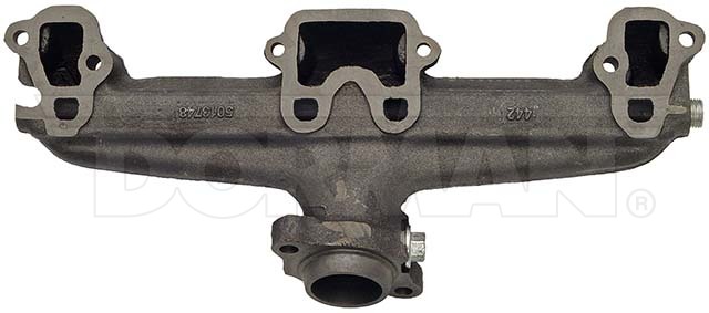

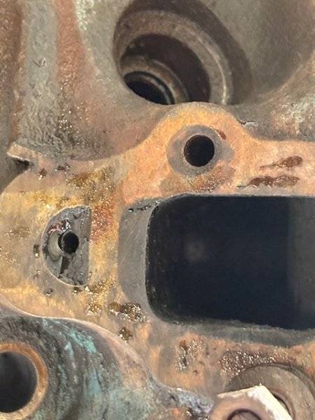

The small holes below the exhaust ports on the pictured heads are the air injection ports. The additional boss material and holes first appeared in 1975 and continued in later years. The matching exhaust manifolds had additional boss material cast into the manifold to either use the ports with an air pump injection system, or additional boss material to cover the ports if air injection was not used, as shown in the following images:
To use the heads with exhaust manifolds or headers that might not cover the holes, resulting in exhaust leaks, drill and tap the holes to 1/4"-20 and install set screws with locking sealant to seal them. Ensure the head of the screw is below the exhaust port machined surface. With the air injection port blocked in this manner, the stock 1969 exhaust manifolds will work without any possible exhaust leaks in this area.

Plugging the air port is a given. I have tapped and put a 1/4-20 set screw, but lately I just clesn with a drill, pound a 1/4" dowel in, cut off and on to the next one.
